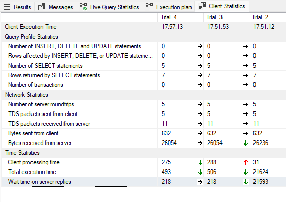

Here is also client statistics with Trial 2 the query ran for the first time and is slow and Trial 3 and 4 afterwards when its running fast.
Does anyone have any idea of what is going on ? Why is that slow in the first execution ? And why if I clear the cache is not slow again and runs fast ?

    This is a standard SQL Server pattern. The first time you run a query it has to do a lot of physical IO, memory allocation raises and it's slow. You may take a look at queries performing slow and they may be showing the PAGEIOLATCH_SH and MEMORY_ALLOCATION_EXT waits and that corresponds to pages being pulled from disk to the buffer. The second time you run the query the data is in buffers and it's fast.
    After a period of inactivity memory allocation drops. Azure SQL Database shrinks memory allocation after the database has not been used for some time or the database tier has been scaled up or down. You will see this happening on Azure SQL Database but not on SQL Server instances (IaaS).
    Another possible reason is queries are waiting for a synchronous statistics update to complete, before the compilation and execution can resume. Please try go enable Async update statistics as explained here. Regularly updating statistics can improve the performance also.
