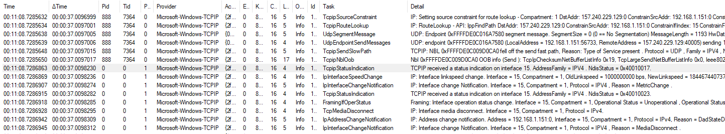

    The trace indicates that we need to move our focus away from the particular type of network traffic and concentrate on power management (although the last packet sent before the "media disconnect" in the second trace was also to Facebook).
    Just searching the web for power management issues related to your network adapter revealed this report:
    Intel Communication: Intel® Ethernet Controller I226 Series-Random connection drops at random times
    As the text in the link says: "a mitigation option to explore is to disable the “Energy Efficient Ethernet (EEE)” mode".
    I think that there is a very good chance that this is the cause of your problems.
