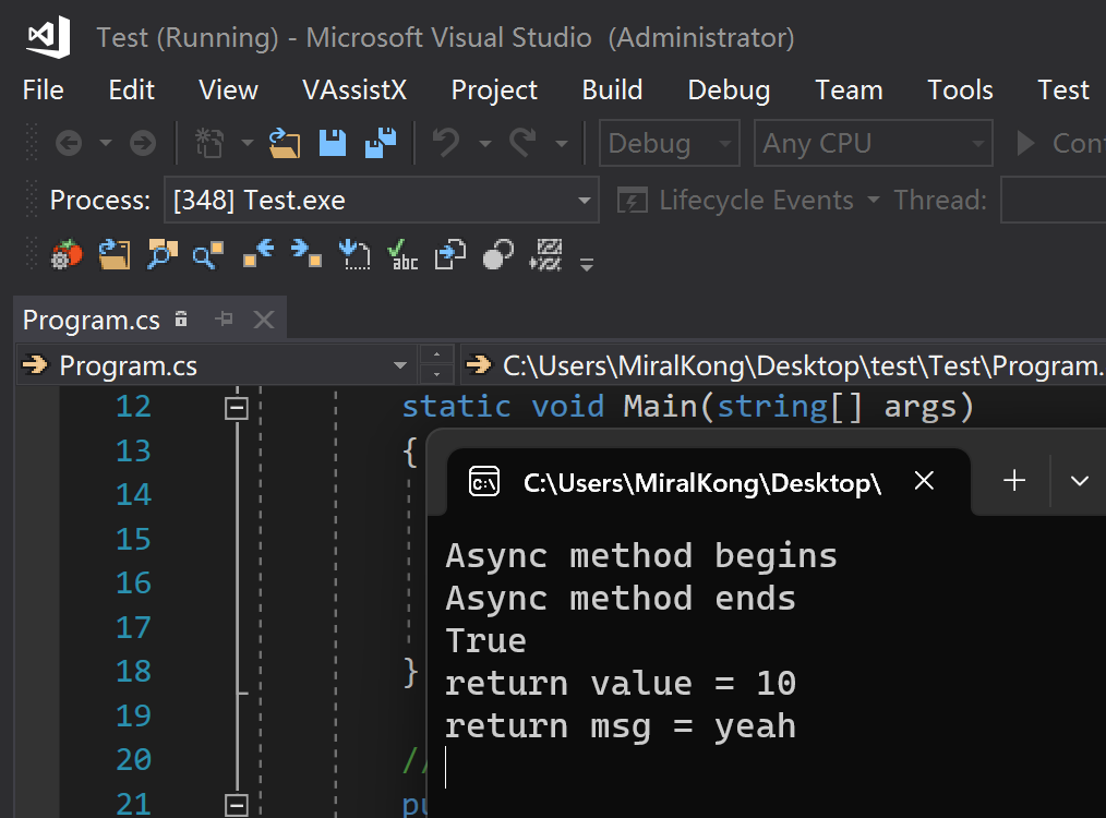

Based on my debug information, the AddXdataAsync method never returns a result. Until Timeout the main thread is keeping running. However when I want to get a result from the Task, it stuck again, which I think it means that the task is still not returning a value. Below is the debug output:
Task begin time: 2023-4-4 14:21:19
Async is about to begin
Async method begin
Async method end
Task end time: 2023-4-4 14:21:29
Task 0:0:10
Main thread keep running
It shows that the async method has already been executed completely. Why does it return a value? Hope someone could give me some tips. Thanks
