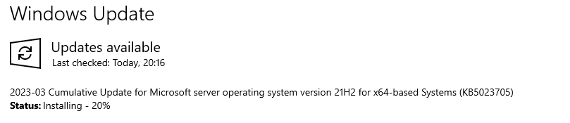

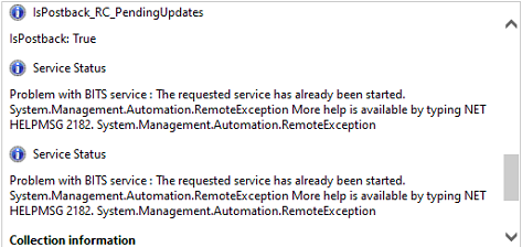

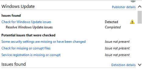

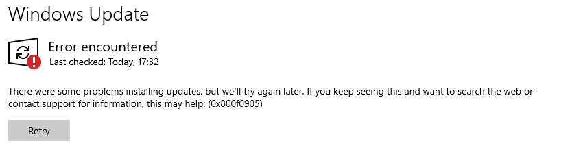

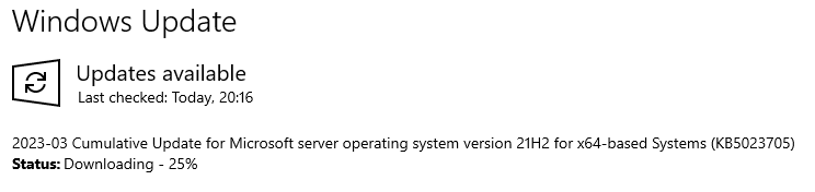

Hello Guys,  I have a problem while update windows server 2022 for the KB5023705 the download ok but installation failed  if someone have a solution or an advice  2023-03-31 14_17_09-Remote Desktop Manager [DC01SRV (FOX DOMAIN)]
2023-03-31 14_26_01-Remote Desktop Manager [DC01SRV (FOX DOMAIN)]
2023-04-03 11_48_07-Remote Desktop Manager [DC01SRV (FOX DOMAIN)]
I tried a lot of solution found:
  • restarting the windows
  • windows update troubleshoot
  • sfc /scannow and  DISM /Online /Cleanup-Image /RestoreHealth
  • install manually of the update  and Tried that solution by running theses commands  net stop bits net stop wuauserv net stop appidsvc net stop cryptsvc Del “%ALLUSERSPROFILE%\Application Data\Microsoft\Network\Downloader*.*” rmdir %systemroot%\SoftwareDistribution /S /Q rmdir %systemroot%\system32\catroot2 /S /Q regsvr32.exe /s atl.dll regsvr32.exe /s urlmon.dll regsvr32.exe /s mshtml.dll netsh winsock reset netsh winsock reset proxy net start bits net start wuauserv net start appidsvc net start cryptsvc  nothing work, still can't install this update Thank you in advance

    Well, after more than a year, dozens rebuilt servers (where the issue came back sometimes), trying all possible bing/google solutions that exist... I found the one that solved it for all my servers! I sincerely hope it will work for you as well as I think I lost half of may hair...
    It looks like the issue lies within language pack (I couldn't find out if there is a specific one but I've seen with 2 different versions). No dsim, no packages, no changing serials, activations, etc...
    What I did was...
    1. Install additional language pack (e.g. if there was US-EN, I've added GB)
    2. Set the display language of the server to the newly installed language pack
    3. Restart the server, remove previous language pack (in my case US-EN) and restart again
    4. All of a sudden... updates are going through on dozens and dozens of servers...
    I hope it helps for you, too!
