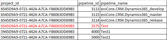

I have temp table with data #temp_table
I have a 2nd table with data - final_table
I want to delete records from final_table , those records that are not in the #temptable, for that projectID only. Meaning I need to delete this record from the final__table.

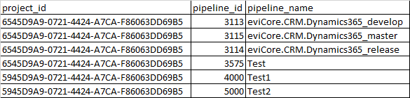

End result on the final_table should be -
I tried a couple of delete stmts, but they all end up deleting that one record for that projectID and also the other records for other projectIDs too.. Any help from anyone is highly appreciated. Thank you folks.
