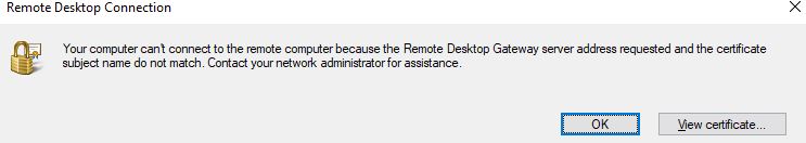

Team, We have configured pretty simple environment with below servers. It was working fine that deployed remote app will work internally without any issues. But now it is prompting as a certificate error as below:
Server 1: Remote Desktop Broker Server
Server 2: Remote Desktop Web Access
Server 3: Remote Desktop License Server
Server 4: Remote Desktop Gateway Server
Server 5: Remote Desktop Session Host 1, 2, 3 and 4
  1. Deployed app via RDSH servers and no issues for some PC and the error not appears
  2. For few users this issue started occurring recently
  3. Installed GoDaddy certificate on the Gateway Server
  4. Not sure what happened and suddenly even local addresses is not bypassing I guess.
Please help.
Thanks, Ram

    3. I am connected to Corporate VPN and logon server is DC2 and I cannot access remote app icon shortcut. Also, not able to access remote app icon from the location \my-domain.com\SYSVOL\my-domain.com\Apps
    4. While I am on VPN, while accessing remote app and this is not bypassing as local address and instead it is trying to reach app via gateway server rdsh1.my-domain.com using a certificate rds.mydomain.com and the certificate subject name mismatch and error occurs
    Now, I need to see why this remote app icon is trying to launch via external certificate even I am on my corporate VPN.
    Please note that this issue is not happening for all users. Sometimes inside my broker server also it happens. It was working fine these days without any issues and this issue started recently before 10 days where we had power outage and all VM’s got turned off and our rdsh old server was not turning on and we cloned from a backup and built a new rdsh1 server.

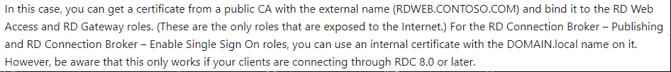

    4. What kind of certificate you've bought from Godaddy? The certificate should have the FQDN of RD Gateway as instructed in below article. https://learn.microsoft.com/en-us/previous-versions/windows/it-pro/windows-server-2012-r2-and-2012/dn781533(v=ws.11)
