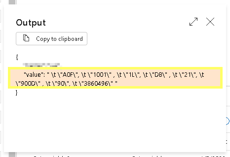

    Hello @sam nick , Thanks for the question and using MS Q&A platform. I am not sure as to how you are planning to use this , but I think I was able to do with with split ,replace and join function . For simplicity I started with the below string.
    	"REF01": "A0F",
    	"REF02": "1001"
    	"REF01": "1L",
    	"REF02": "DB"
    	"REF01": "21",
    	"REF02": "900D"
    	"REF01": "90",
    	"REF02": "3860496"
    Steps
    1. Transformed this into a simpler string by using the dynamic expression
       @replace(replace(replace(replace(replace(variables('jsonstring'),'[{','' ),'}, {',','),'}]',''),'"REF01":',''),'"REF02":','')
    1. Used the string from step 1 and used the split function as added the text in an array
       @split(variables('jsonstring1'),',' )
    1. Used the join function on the array .
    @join(variables('array1'),',' )
    This is output you have.
    Let me know if this helps.
    Thanks Himanshu Please accept as "Yes" if the answer provided is useful , so that you can help others in the community looking for remediation for similar issues.
