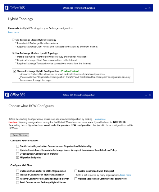

It fails at the Validate Hybrid Agent for Exchange Usage. The error I am seeing in the log is: ERROR 10349 The connection to the server 'guid.resource.mailboxmigration.his.msappproxy.net' could not be completed.... unable to connect to the remote server with the credentials provided. The call to 'https://guid.resourec.mailboxmigration.his.msappproxy.net/EWS/mrsproxy.svc' failed. Error details: The HTTP request is unauthorized with client authentication scheme 'Negotiate'. The authentication header received from the server was 'Basic realm I have disabled and re-enabled MRSProxy, I have enabled basic authentication on the EWS site. Am I using the wrong credentials there? If so, what am I supposed to use there?

    The Mailbox Replication Service was unable to connect to the remote server using the credentials provided. Please check the credentials and try again. The call to 'https://6fbbfcd9-9983-4bc7-8c9f-d44e461f6d24.resource.mailboxmigration.his.msappproxy.net/EWS/mrsproxy.svc' failed. Error details: The HTTP request is unauthorized with client authentication scheme 'Negotiate'. The authentication header received from the server was 'Basic realm="6fbbfcd9-9983-4bc7-8c9f-d44e461f6d24.resource.mailboxmigration.his.msappproxy.net",Negotiate,NTLM'. --> The remote server returned an error: (401) Unauthorized.. --> The HTTP request is unauthorized with client authentication scheme 'Negotiate'. The authentication header received from the server was 'Basic realm="6fbbfcd9-9983-4bc7-8c9f-d44e461f6d24.

    Hi @ Ryan Wilderman ,
    Based on this error message, the issue may be due to the migration endpoint password in wrong on On-Premises end.
    I recommend that you refer to the following link to reset the password for the account used to set up the migration endpoint to see if the issue persists:
    Office 365 Mailbox Move Fails – The Remote Server Returned An Error (401) Unauthorized. (cloudiffic.com)
