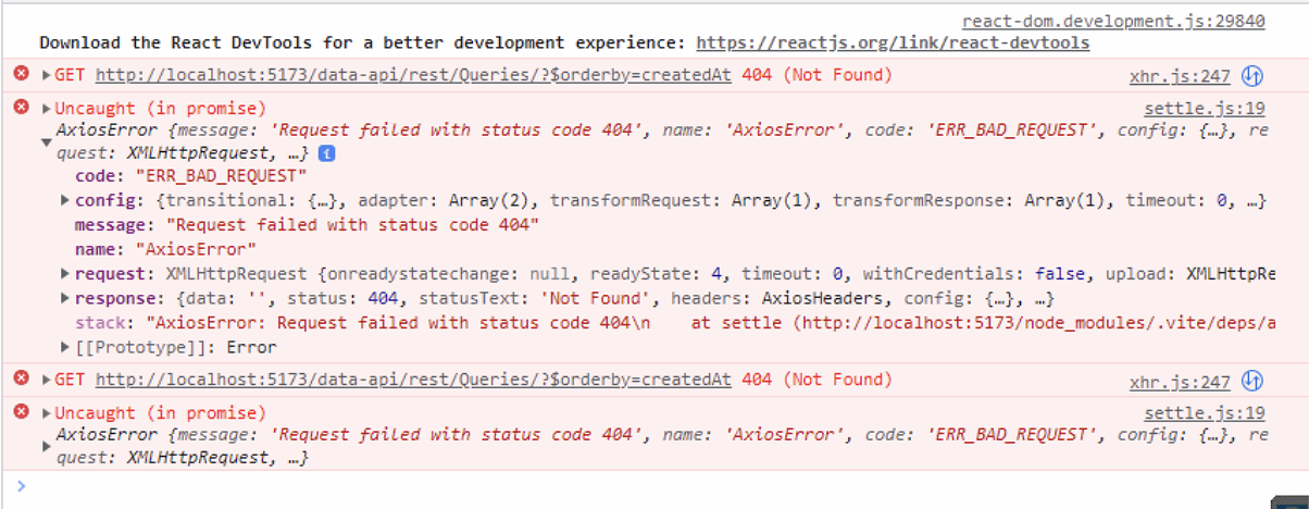

Hi I am trying to connect my Azure Sql Database to my Azure Static Web Apps following this tutorial:
https://learn.microsoft.com/en-us/azure/static-web-apps/database-azure-sql?tabs=bash&pivots=static-web-apps-rest
I am successful when hosting a local server using:
swa start ./src --data-api-location swa-db-connections These are the request functions I use in my vite react appUser's image
Caveat: Since my app runs on localhost:5173, I had to append https://4280 to the endpoint string for it to work locally. However I have removed it when pushing to github to build for the static web app.

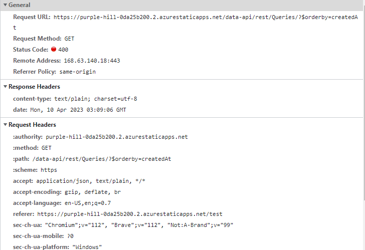

However when pushing the same code to build for static web app in deployment, I am faced with this error:
Please advice!

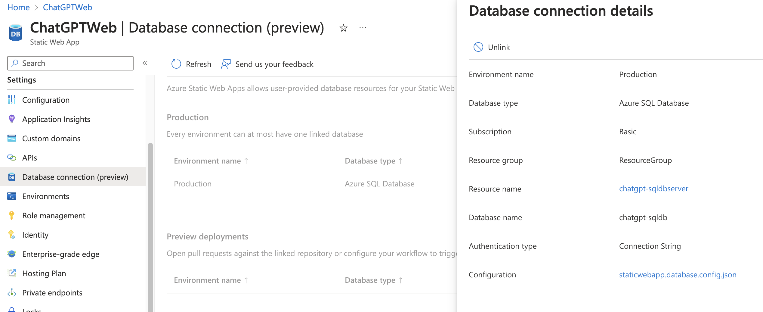

    Upon investigating deeper, we see that there is a mismatch between the password of sql database and also the linked sql database connection of static webapp.
    • Using the below cmdlet customer is able to see which password does the static webapp is using to access the db.
    az rest --method POST -u /subscriptions/SUBSCRIPTION_ID/resourceGroups/RESOURCE_GROUP/providers/Microsoft.Web/staticSites/APP_NAME/databaseConnections/default/show?api-version=2022-09-01
    • Since customer is using sql authentication, suggested them to reset the password of the user and try unlinking and linking the database connection to static webapp. Post that customer confirmed that it is working fine.

    2. Ensure that your database is connected to your Static Web App in the Portal with the correct credentials
    3. Ensure that your database has its network configured to accept requests from Static Web Apps https://learn.microsoft.com/en-us/azure/static-web-apps/database-azure-sql?tabs=bash&pivots=static-web-apps-rest#configure-database-connectivity
