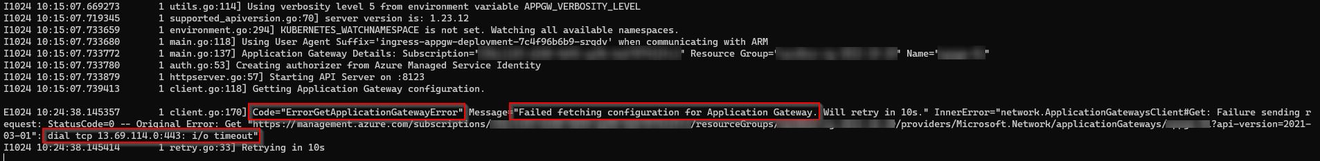

    Network connectivity to Azure Resource Manager In order to be able to fetch and apply updates to the Application Gateway configuration, the AGIC pod requires TCP/IP connectivity to the Azure Resource Manager REST API endpoint (management.azure.com) over port 443. This outbound connectivity requirement is clearly stated in AKS Egress Traffic Requirements public documentation. If for some reason this connection cannot be established, the AGIC pod logs will display the error "ErrorGetApplicationGatewayError" with message "Failed fetching configuration for Application Gateway", followed by the lower level TCP error message "dial timeout" and "Retrying in 10s", which indicates AGIC will keep retrying to connect to this endpoint. If for some reason this connection cannot be established, the AGIC pod logs will display the error "ErrorGetApplicationGatewayError" with message "Failed fetching configuration for Application Gateway", followed by the lower level TCP error message "dial timeout" and "Retrying in 10s", which indicates AGIC will keep retrying to connect to this endpoint. User's image
    If that is the case, please make sure you allow the traffic with management.azure.com over port 443.
