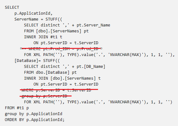

  2. LiHongMSFT-4306 31,571 Reputation points
    2023-04-07T01:58:17.6133333+00:00
    Hi @Ahmed Salah Abed Elaziz Modify your initial code by removing three red lines as shown in below pic. User's image
    Best regards,
    Cosmog Hong
