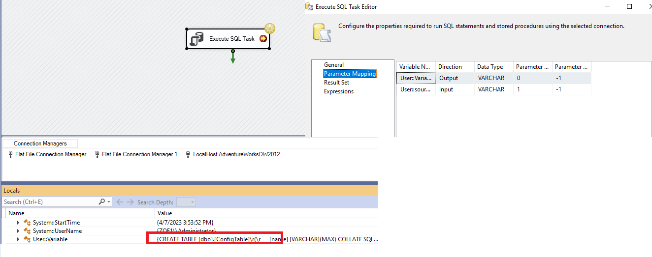

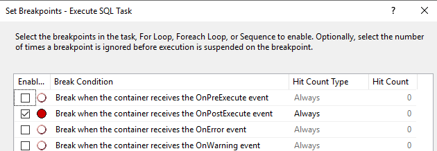

  1. ZoeHui-MSFT 41,491 Reputation points
    2023-04-07T07:55:41.19+00:00
    Hi @Nishan Ratna ,
    Please have a double check that I could get the value from the excute sql task.
    I set the resultset to none and set like shown below.
    Regards,
