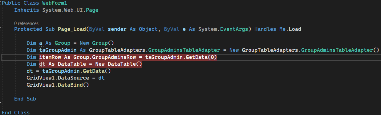

    Hi @Robert Barnes, You need to initialize. You can refer to my code below, I did a simple test with gridview.
    Dim a As Group = New Group()
            Dim taGroupAdmin As GroupTableAdapters.GroupAdminsTableAdapter = New GroupTableAdapters.GroupAdminsTableAdapter()
            Dim itemRow As Group.GroupAdminsRow = taGroupAdmin.GetData(0)
            Dim dt As DataTable = New DataTable()
            dt = taGroupAdmin.GetData()
            GridView1.DataSource = dt
            GridView1.DataBind()
