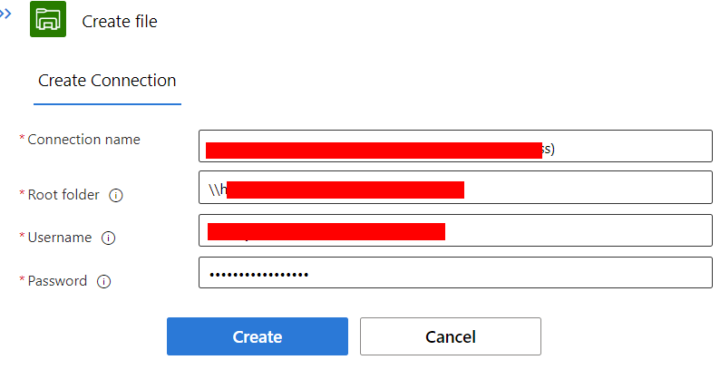

Hi All, I am trying to connect to the on-prem. file system using 'File system' built-in connector. When I specified the root folder and created a connection, User's image
the FileSystem_mountpath is created under Configuration with the value 'C:\mounts\fileSystem. User's image
When I tested the connection, I got the following error. {"statusCode":"Unauthorized","body":{"code":"ServiceProviderActionFailed","message":"The service provider action failed with error code 'Unauthorized' and error message 'Access to the path 'C:{filepath from the action}' is denied.'."}} Is my setup okay? or should I remove C: ? because the on-prem file directory is not starting with C: but \{servername}\folder Thank you.

    Further you may want to know that the File System connector uses the App Service BYOS feature to mount the file share to a specific path. So, when a new connection is created, designer updates the config to mount the file share to C:\mounts<connection-id> and the mount path is then written to connections.json.
    The Logic Apps runtime only uses this mount path for any of the action/trigger executions.
    However please note that a connection created successfully still doesn’t guarantee that the mount was successful. Due to networking constraints of the file share/logic apps, the file share might still not be accessible from Logic Apps.
    Suggest you to check if the mount path exists from the file system through the Kudu console to ensure that the connection properly works. Please refer to below articles would be helpful: Using File system connector in Logic Apps Standard Connect to on-premises file systems from workflows in Azure Logic Apps Please let us know if further query or issue remains.
