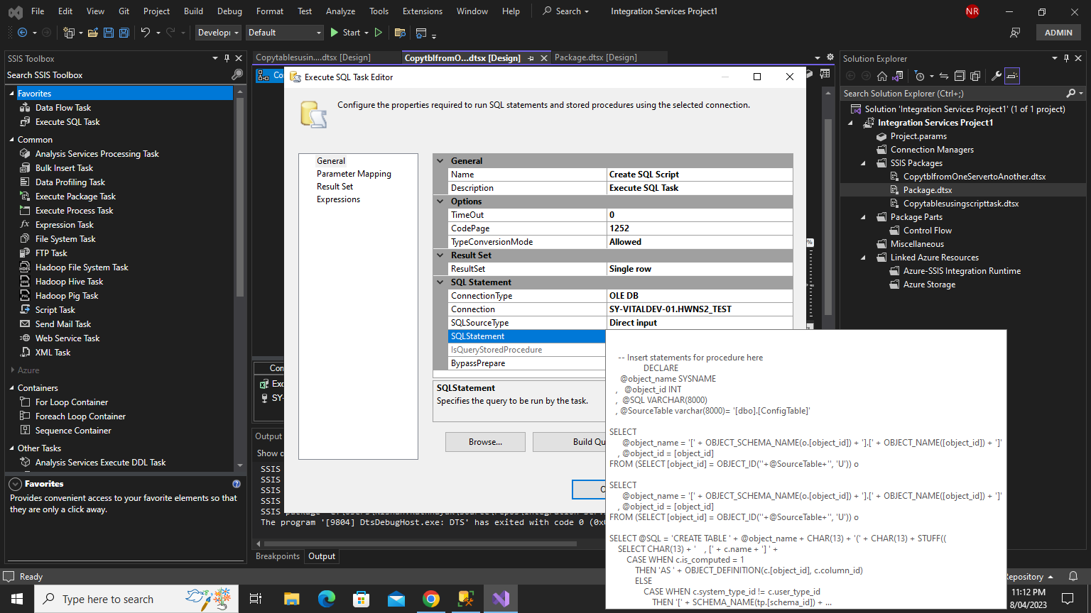

The following code is used in execute sql task. Result set is set to single row. There is one input parameter. Result is set to a single row. The result is saved into a variable. it is called CreateSQLscript. The problem is that variable is empty. It does not show any value, though input parameter correctly changes values, Can anyone tell me why my result is empty ? Can anyone help me to fix this issue please? This is the code I used in execute sql task.

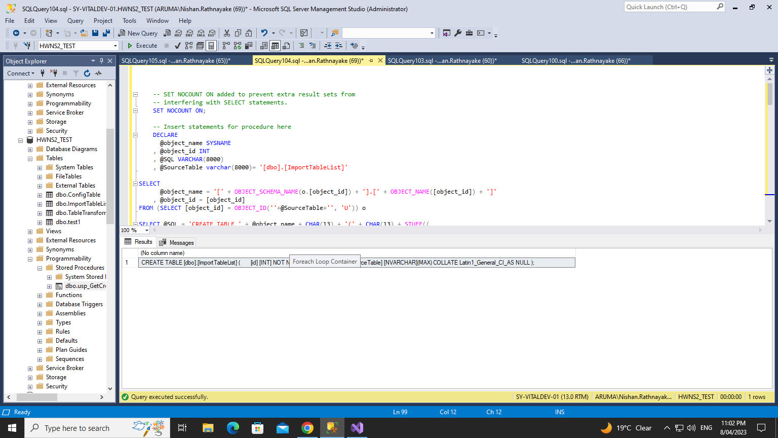

when I run the same query (hardcoded) in management studio, I get the following result. User's image

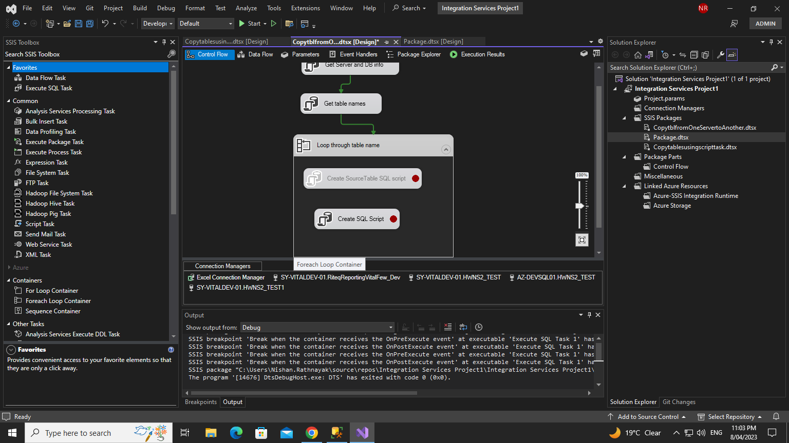

This is the package. User's image

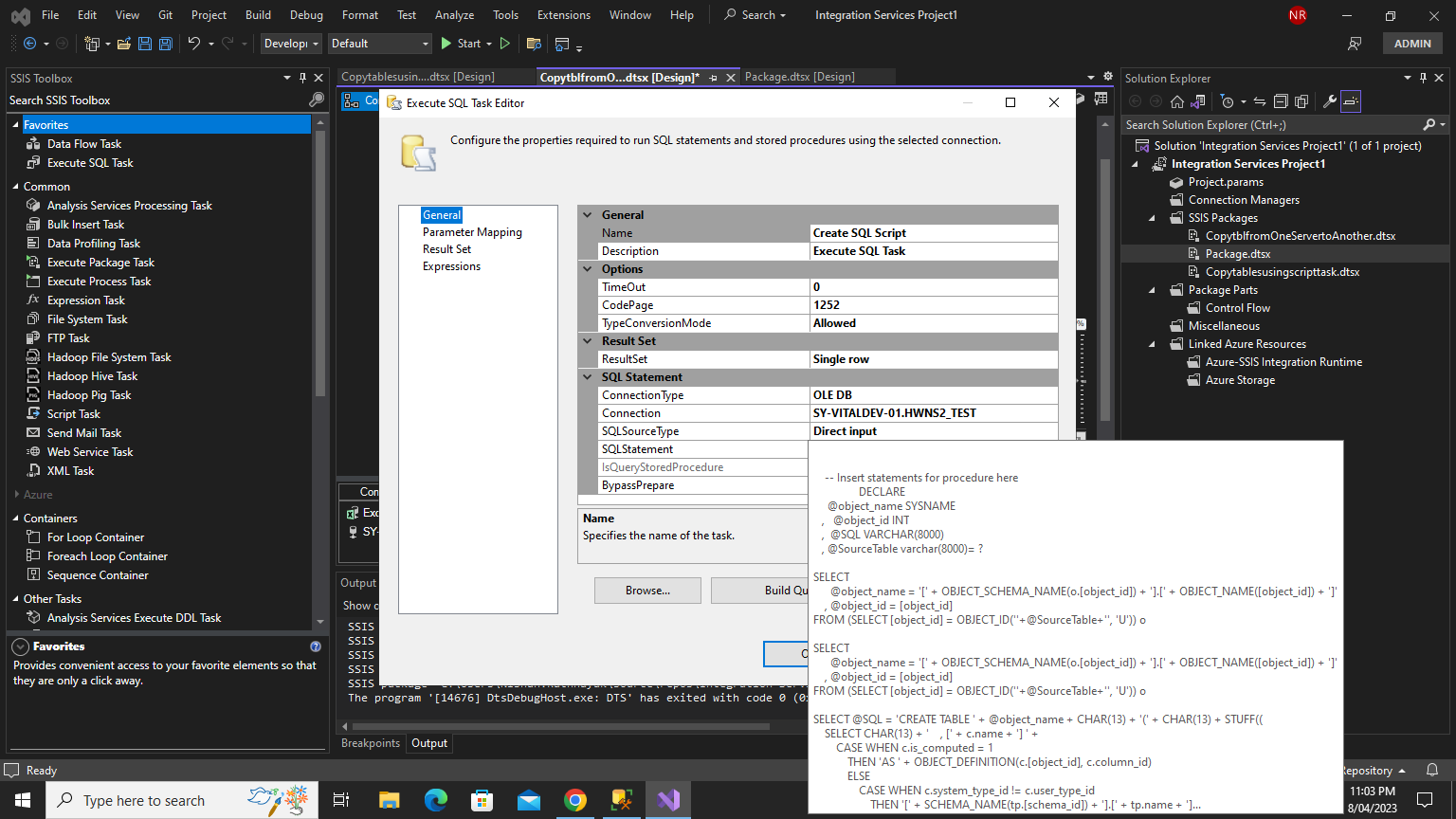

This is the general setting of execute sql task. ( create sql script) User's image

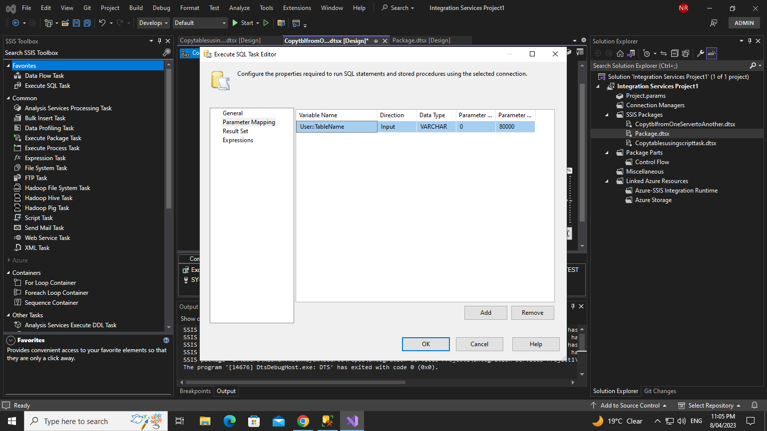

This is the input parameters. User's image

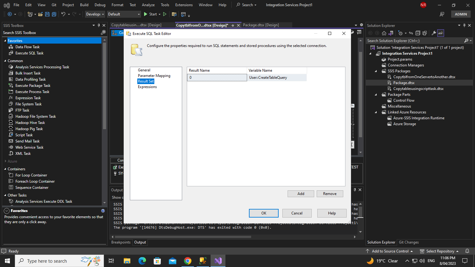

The query result is saved in this variable. User's image
When I use the hardcoded code, CreateSQLScript variable, shows the value. that means it holds the query result. It looks like Create table part of the query is causing the problem. I am not sure how to fix this.User's image
