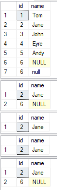

    In may not be used here. I tested the method to solve the performance problems caused by or. Union all is suitable for NULL:
    select * from a
    select * from a
    where name ='Jane' or name is null
    select * from a
    where name in('Jane',null)
    select * from a
    where case when name ='Jane' then name else NULL end=name
    select * from a where name='Jane'
    union all
    select * from a where name is null
    For the delete statement, it can be divided into two queries,please check if it works:

    But if there is only the empty string'NULL' in your data, there is no NULL, then you can refer to:
      DELETE  f
              FROM    Parts.ChemicalProfiles f
                      INNER JOIN #TempPC t
                      ON t.ChemicalID = f.ChemicalID
              WHERE  case when t.[status]='Not Found in Chemical Master' then t.[status] else 'NULL' end=t.[status]
    Or:
      DELETE  f
              WHERE  t.[status] in('Not Found in Chemical Master','NULL')
