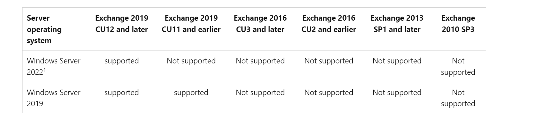

  1. Andy David - MVP 157.8K Reputation points MVP Volunteer Moderator
    2023-04-10T15:15:47.9333333+00:00
    If you are running the Forest steps for Exchange 2019, you have to run a on supported O/S, yes. You cant run Exch 2019 binaries on a W2012R2 server. https://learn.microsoft.com/en-us/exchange/plan-and-deploy/supportability-matrix?view=exchserver-2019#supported-operating-system-platforms User's image
