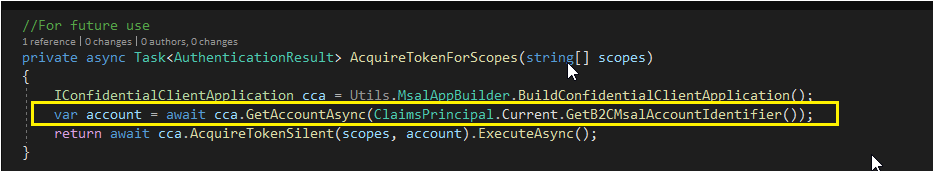

Hello All, We have configured web app and web api on Azure as per the sample code and instructions provided by Micosoft (https://github.com/Azure-Samples/active-directory-b2c-dotnet-webapp-and-webapi) What is the issue? When I am trying to access the token in web controller, I am getting the following error: "No account or login hint was passed to the AcquireTokenSilent call." Refer the following image where we can making a call to get the token. User's image

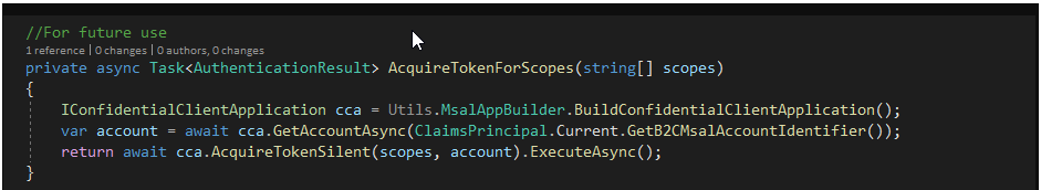

Refer the following image where the method details are there. User's image

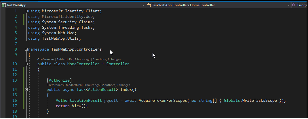

The main issue is, account is coming as null. Refer the following image:-User's image

    The error message "No account or login hint was passed to the AcquireTokenSilent call" indicates that the user is not authenticated, or the token cache is empty.
    If you want to acquire a token silently, you need to ensure that the user is already authenticated and that the token cache is not empty. AcquireTokenSilent() attempts to acquire an access token for the account from the user token cache.
    The recommended pattern is to call the AcquireTokenSilent method first and if it fails with a MsalUiRequiredException, then acquires a token interactively using AcquireTokenInteractive().
