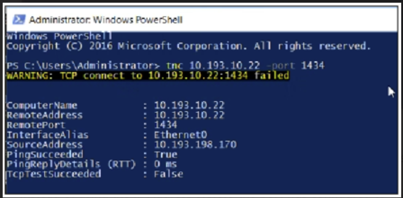

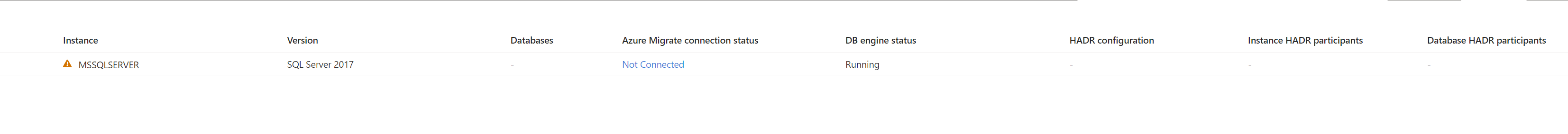

Hi, Wonder if someone can assist. I am running an Azure migrate assessment for on-prem sql to get recommendations on the cloud. The assessment says DB Engine Running however Azure Migrate COnnection Status : Disconnected for SQL We ran an assessment yesterday and it has pulled some data down however the confidence level is 1 * I have ran all the troubleshooting steps and can't get sql to talk properly Has anyone had similar issues ? thanks Kash

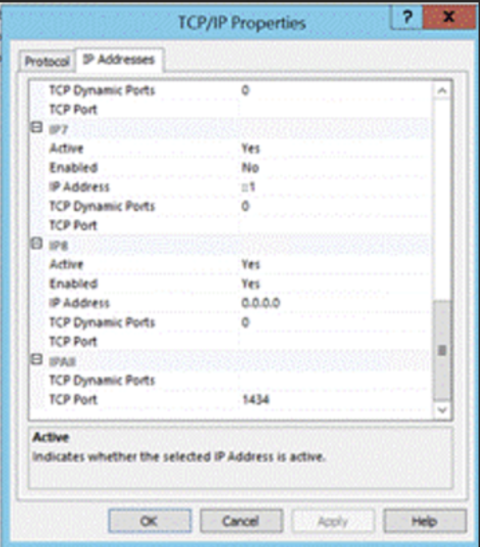

    Make sure that the SQL Server is configured to allow remote connections. You can do this by opening the SQL Server Configuration Manager on the SQL Server and enabling the "TCP/IP" protocol.
    Verify that the SQL Server instance is configured to use the default SQL Server port (1433). If it is using a non-default port, you will need to specify the port number in the connection string.

    thanks for the answers. I found out that appliance didn't have SQL discovery and assessment agent in running status which I have ran the diagnostic tools and fixed the SQL status still shows as disconnected for now however it does say that a check-in can take up to 24 Hours for this so I hoping this will help. Going back to firewall etc.
    • SQL and Azure Migrate appliance sit on same network and can talk to one another fine
    • both above can get on to internet fine too
    • SQL instance runs on 1433 and is not filtering any traffic to it
    • TCP/IP named pipes are enabled Will post back further once I have more information by tomorrow
