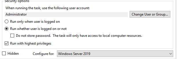

  • The script is set to run as an administrator account, with highest privileges, whether logged in or not, and configured for Win Server 2019

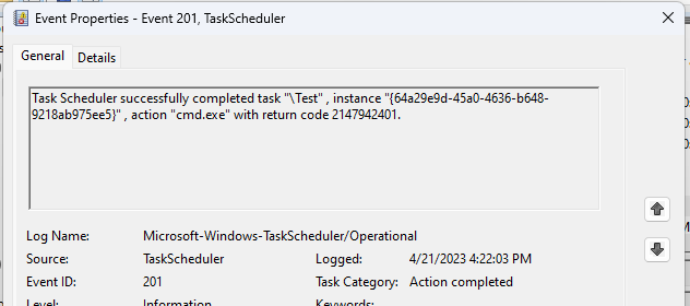

  • However, when I call it with Task Scheduler (even clicking Run manually rather than waiting for the scheduled time), it doesn't seem to do anything. Looking at the history, it says it successfully completes it though, oddly.

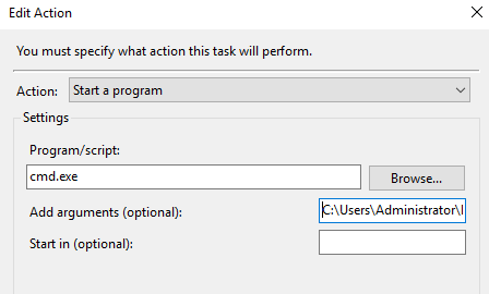

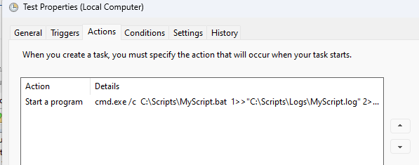

  • As a workaround I also tried creating a .bat file and entering cmd.exe as the Program/script field and the location of the .bat file in the argument field C:\Windows\System32\WindowsPowerShell\v1.0\powershell.exe -File "C:\Users\Administrator\Documents\BackupData.ps1" 1>C:\Windows\temp\BackupData.log 2>&1 But unfortunately this also didn't work. I also don't see log files for it. Not really sure what's going on. Any help would be appreciated. Thanks.
