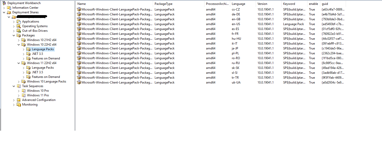

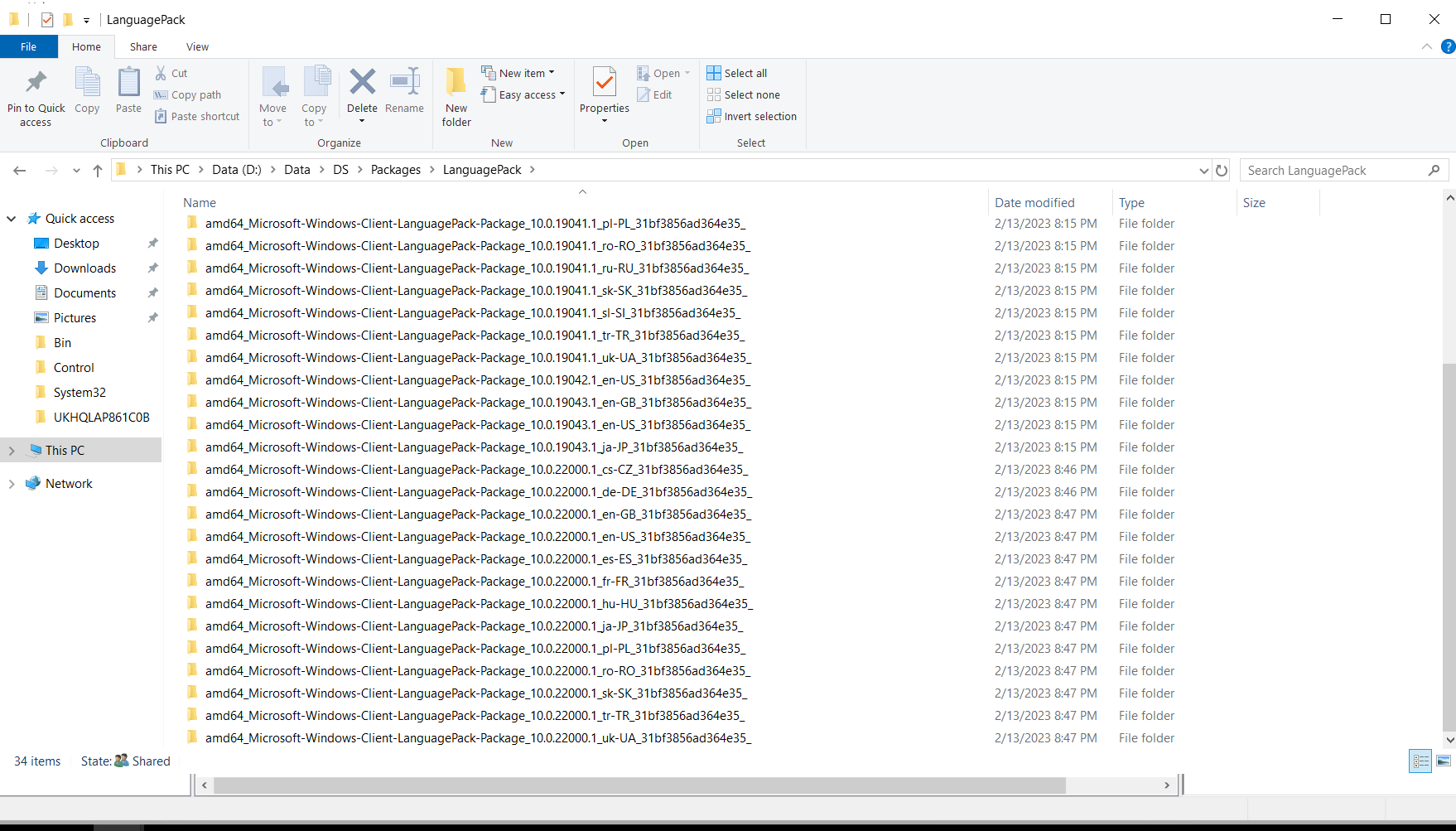

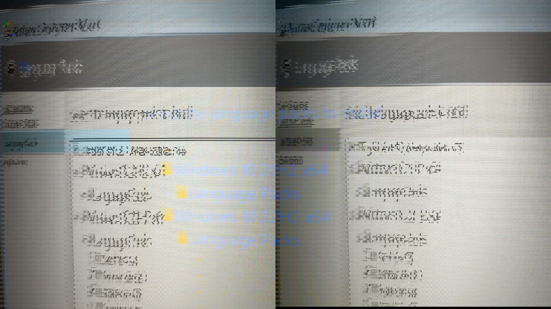

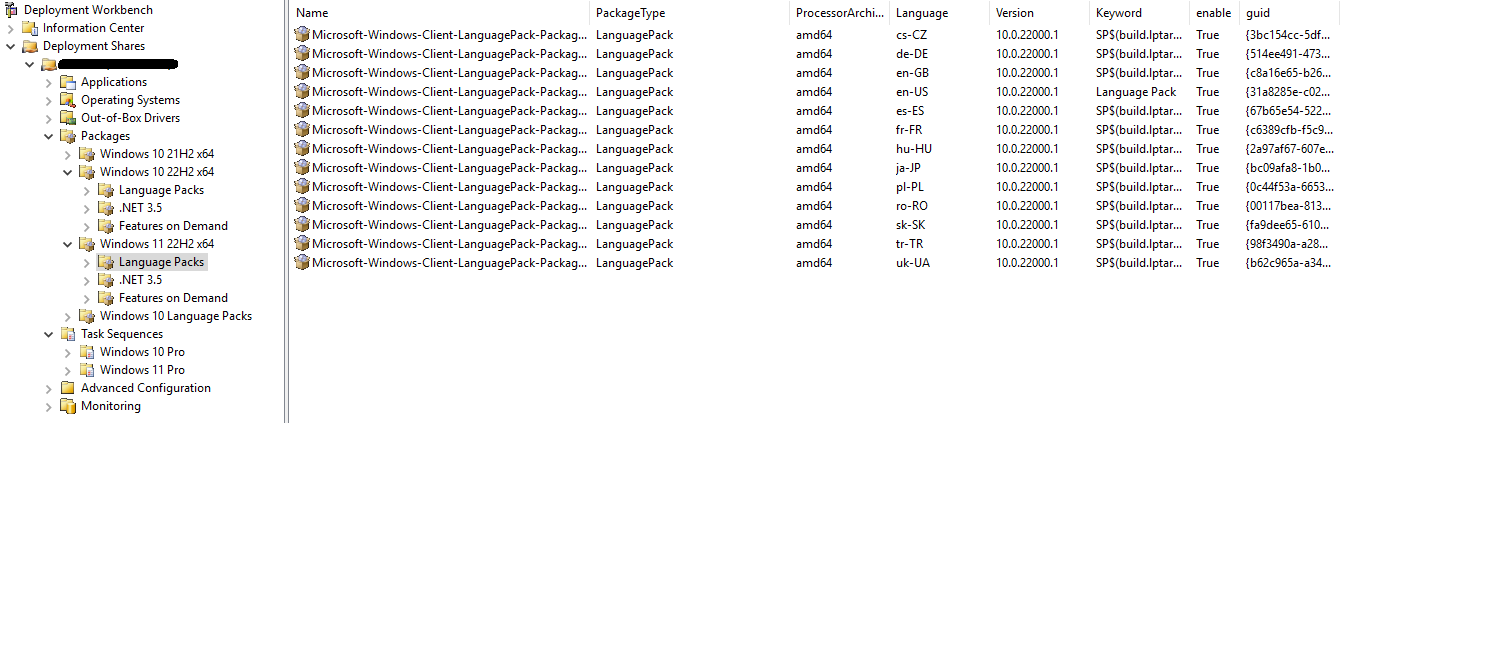

Hi all, We are having a problem with Windows 11 Language Packs not showing up in the PE Deployment Wizard when building new laptops, i've tried recreating the task sequence from scratch to which we still have the problem. Our ADK and PE environments are on the new version for Windows 11. We also build Windows 10 PCs using this version and those packages are ok, they show up in the PE wizard, just the windows 11 ones dont (see attached image of the wizard and MDT locations. Any additional info required, then please let me know. Thanks Adam MDT Wizard no Win 11 Lang
Win 10 Packages
Win 11 Packages

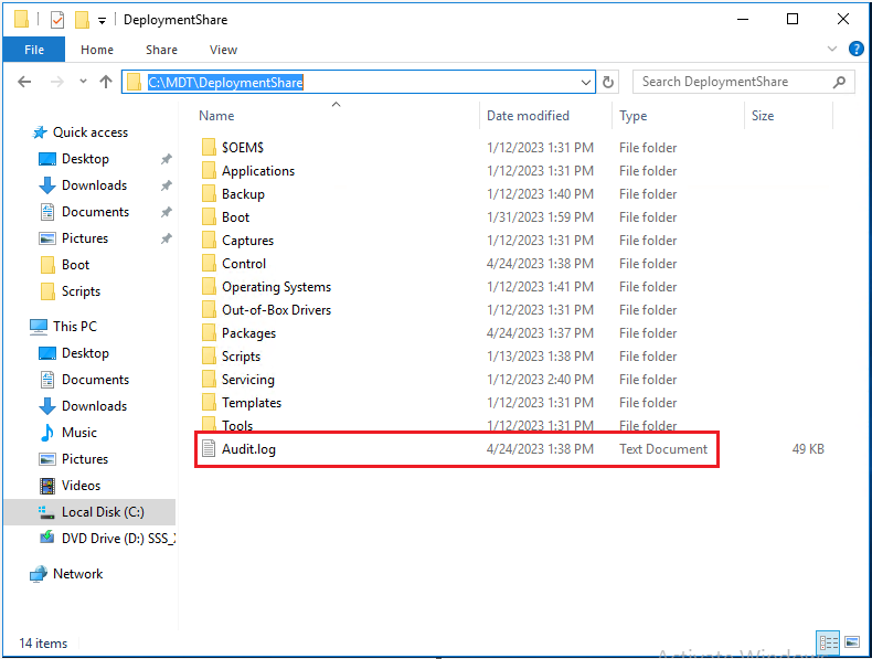

    • A log will be created when we import the package, as shown in the screenshot. Please help check it to see if there are any useful information. 1

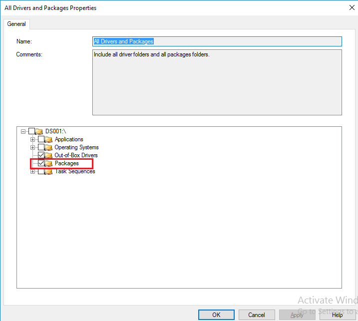

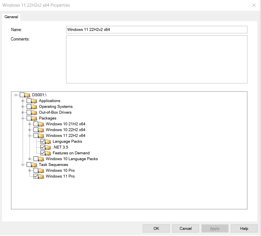

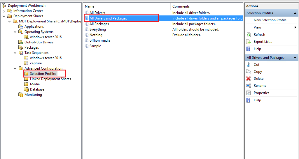

    •  Please help confirm that the related folder has been selected in Selection Profiled. The screenshot for your reference:
    • 2 3
    • Please help confirm that if the related folder is shown in the DeploymentShare$ folder, as shown in screenshot: 4

    1, Please try to also check the box Window 11 22H2 x64,
    2, Where did you get the language package? We may try to regain and impot it again.
    I will be sharing for you if I have any update. Thanks for your time and patience!

  4. Brecht Mo 0 Reputation points
    2023-08-31T15:58:23.5966667+00:00
    I ran into the same issue. I think it's important to include an "apply patches" in the postinstall step with a selection profile that includes your language packs. Only then will the wizard offer you the choice to install them.
