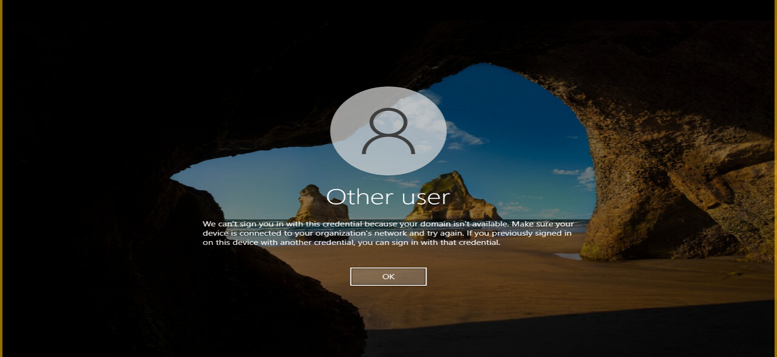

We have one Primary domain controller and one secondary domain controller. FSMO roles are present at primary domain controller. When create new user at primary domain controller user also replicated at secondary domain controller. But the issue is when we shut down the primary domain controller, we cannot login user's computer with the user's domain credentials. Below errors is showing. User's image

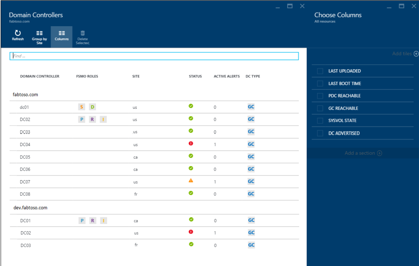

    Once you have connected Azure AD Connect Health, you can check the health of your domain controllers by going to Azure AD Connect Health > Domain Controllers dashboard. If there are any issues, you should see them listed here.

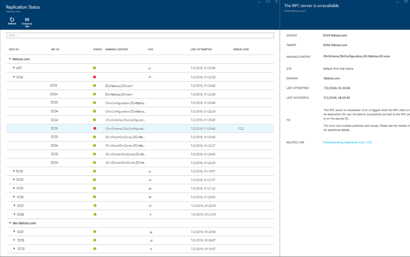

    Then you can check the Replication status dashboard and drill in to see errors related to replication:
