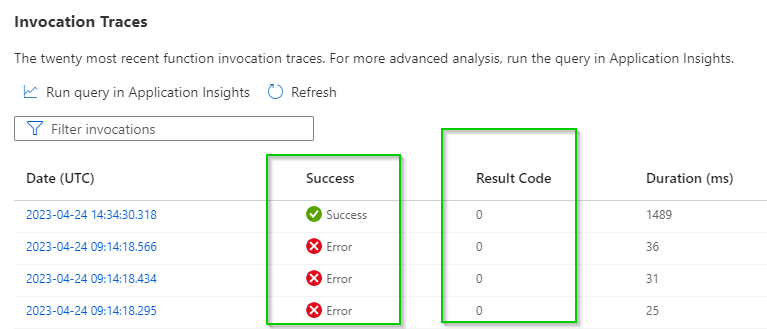

I have created a queue-triggered Azure function, written in Python. It uses the V1 programming model, meaning that it does not use the decorators. Instead, it uses the function.json file to define the function's bindings. My question is whether I can use the $return binding to indicate to the system that the function has succeeded or failed. I have a use case where the queue message contains some invalid input and I want the function to fail on it, but in an orderly manner. For now, I'm raising an exception on the failure and it causes two problems:
  1. The function has not really failed
  2. Due to the failure, the function is invoked 4 more times with same input, so it fails 4 more times. This is a waste of resources and logs.
The documentation is not too helpful on the return binding - only one example is provided, for a storage blob return. Thanks

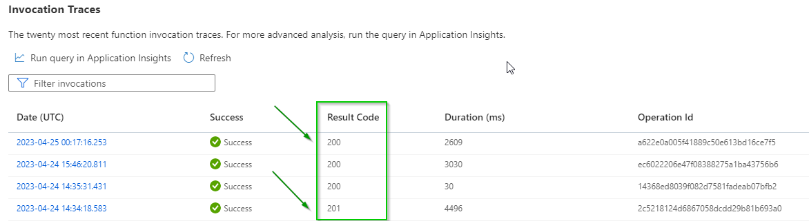

  1. Amir Katz 80 Reputation points
    2023-05-02T06:58:33.16+00:00
    An additional update:
    As suggested by Konstantinos, I modified the function to return an HTTP response (adding a $return binding in function.json) and returning an HTTP response in the code:
    return func.HttpResponse('some message', status_code=400)
    This does not work. When the function is invoked, I get this error in the invocation log:
    Unable to cast object of type 'System.String' to type 'Microsoft.AspNetCore.Http.HttpRequest'.
    The same binding and return code do work in my HTTP-triggered function.
    So my conclusion is that, for now, a queue-triggered function cannot have any $return binding.
