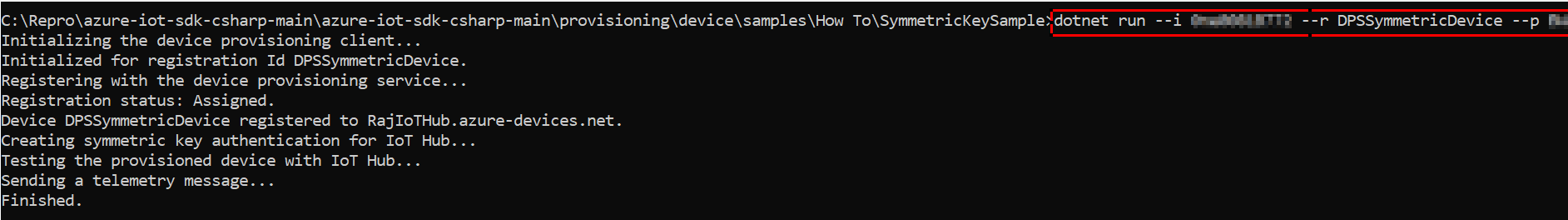

Hi @Kumpala, Deepak DEEKU Greetings! Welcome to Microsoft Q&A forum. Thank you for posting your question here. Please leverage the sample code provided in the GitHub repository to Azure IoT SDK Csharp to provision a device using Symmetric Keys. The GitHub repository has a SymmetricKeySample.cs
file with the code to provision the device. The file can be found under the directory azure-iot-sdk-csharp-main\provisioning\device\samples\how to guides\SymmetricKeySample
The code does not require any changes and you can execute the project through the command line by passing the DPS instance ID scope, Registration ID and the SAS key. Please refer the below image for reference

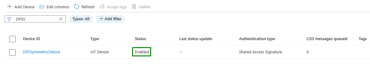

Upon execution of the command, you can see that the device gets provisioned on the IoT Hub. Find the below image for the reference.
Refer the instructions provided in the Quickstart: Provision a simulated symmetric key device to get more details on the steps needed to set up and execute the demo code.
