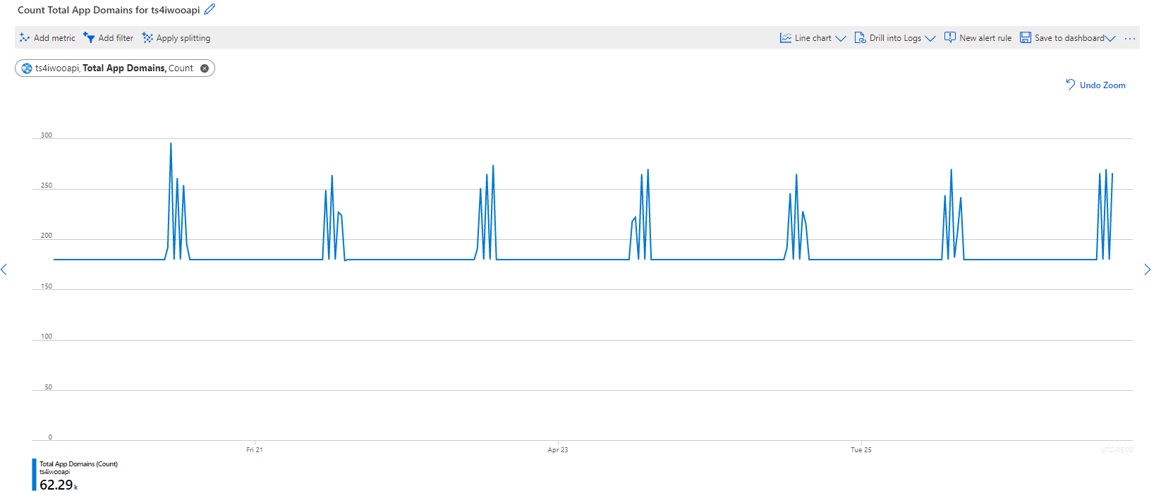

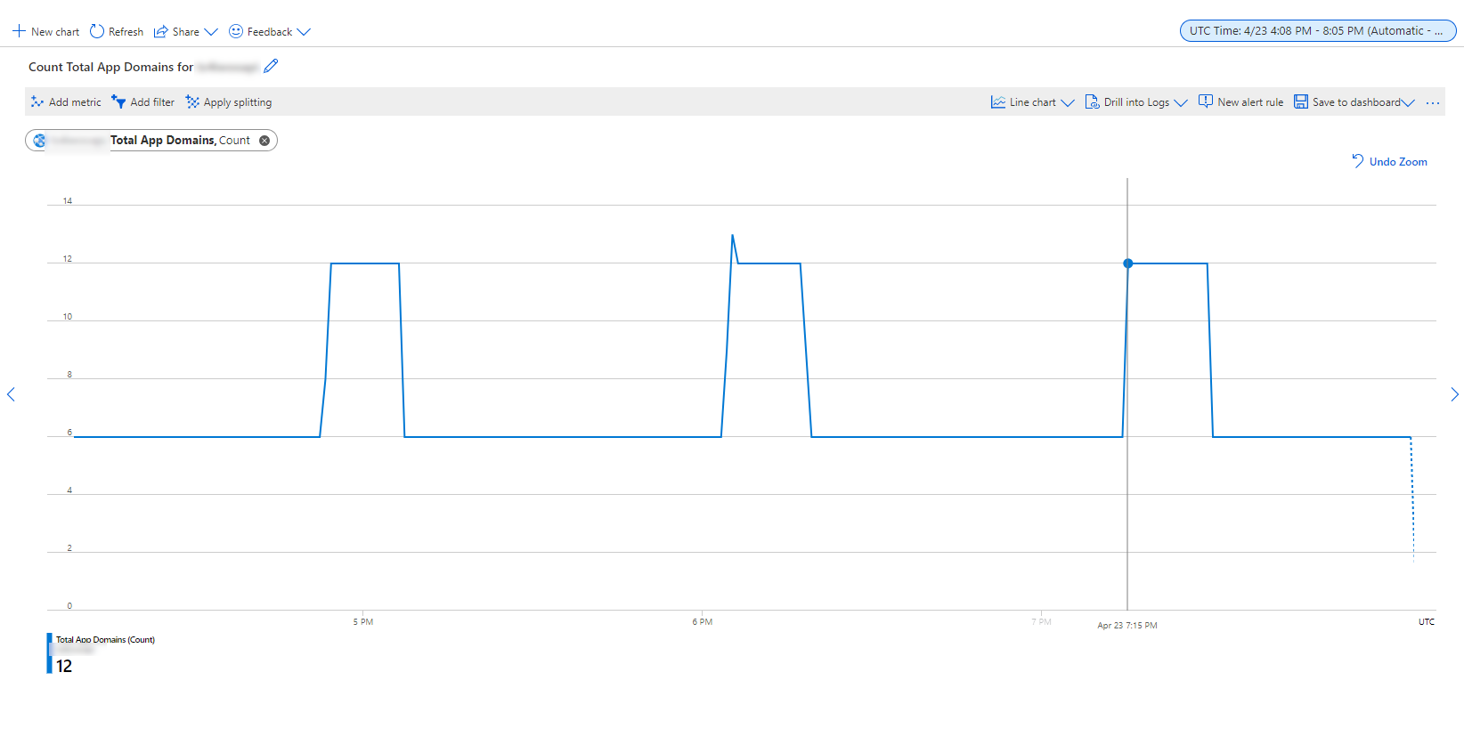

In the Web App Metrics the Count of Total App Domains is one of the indicators I'm looking at to know when each of these 15 min recycles is happening (See Image Below).

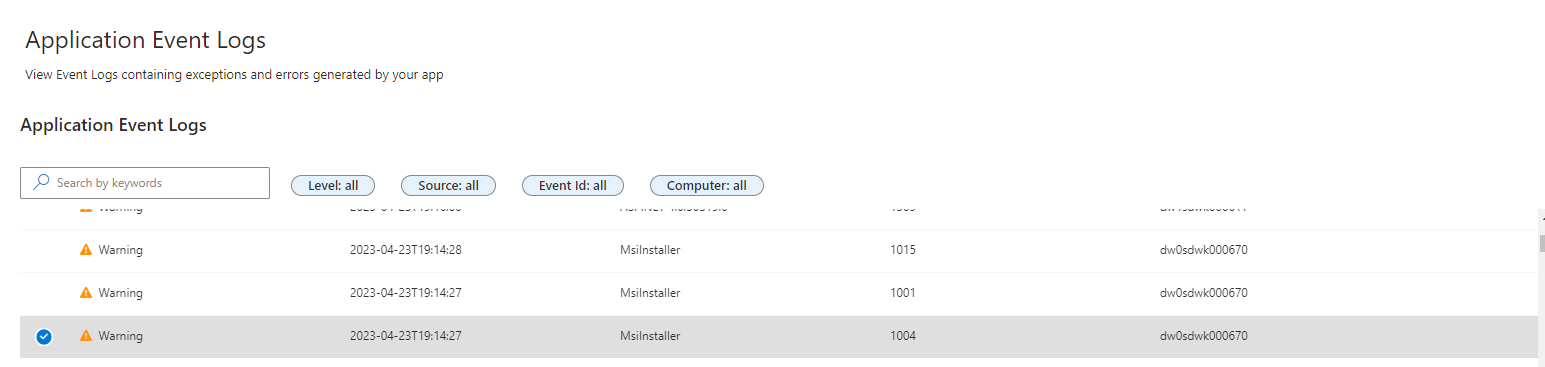

The Web App Application Event Logs also show the following three MsiInstaller Warnings each time the app is recycled.

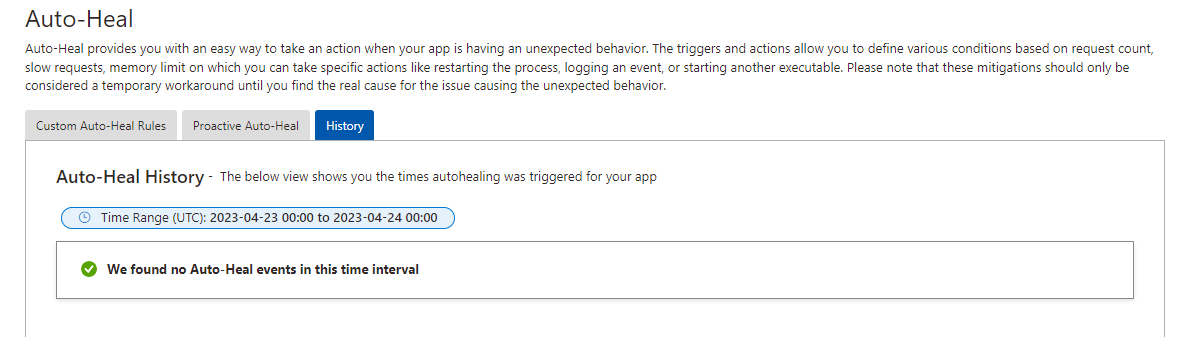

These instances do have Proactive Auto-Heal enabled, but the Auto-Heal history doesn't show any events in this 24 hour window.

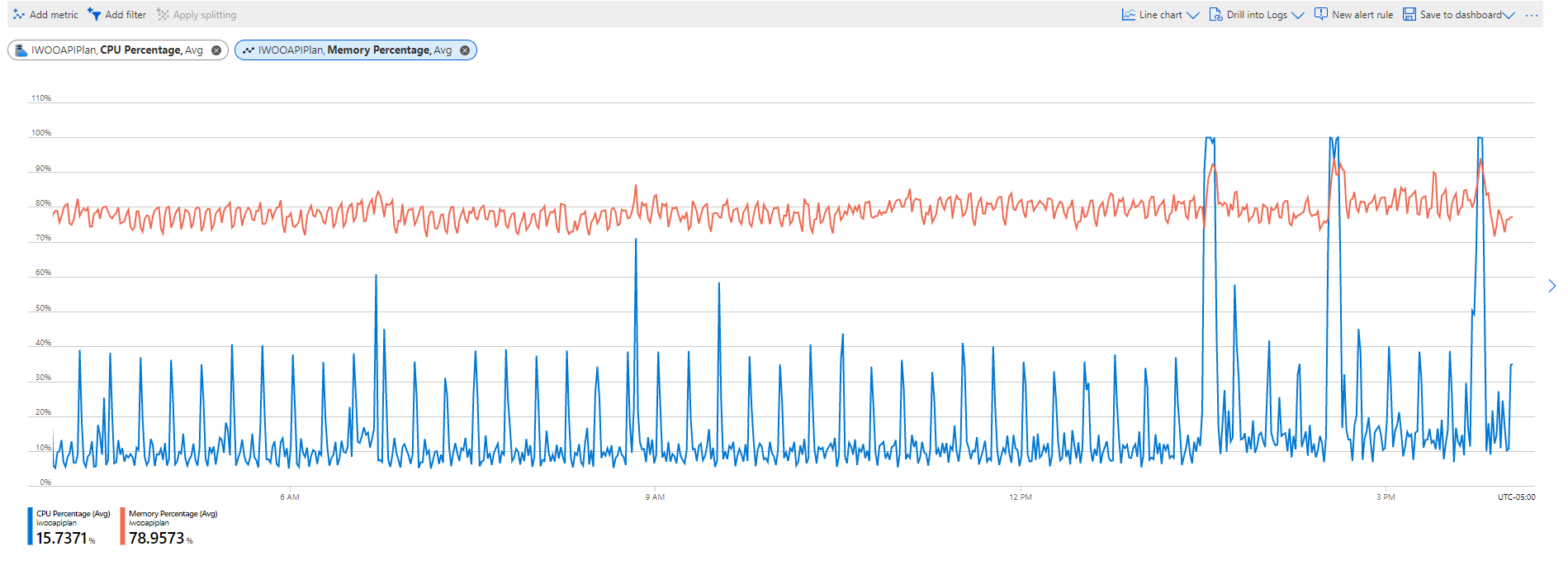

    1. One possible reason for the issue could be that the App Service Plan (ASP) is running out of resources, such as memory or CPU. You can check the resource usage of your Web App by going to the "Metrics" section in the Azure portal and selecting the appropriate metrics, such as CPU usage or memory usage. If you find that the resource usage is consistently high. (If feasible), I understand you’re looking to understand the cause of the recycle problem and plan to handle this in socket, the following would help isolate the issue. you can consider moving the Web Apps to separate ASP or scaling up the existing App Service Plan to a higher tier.

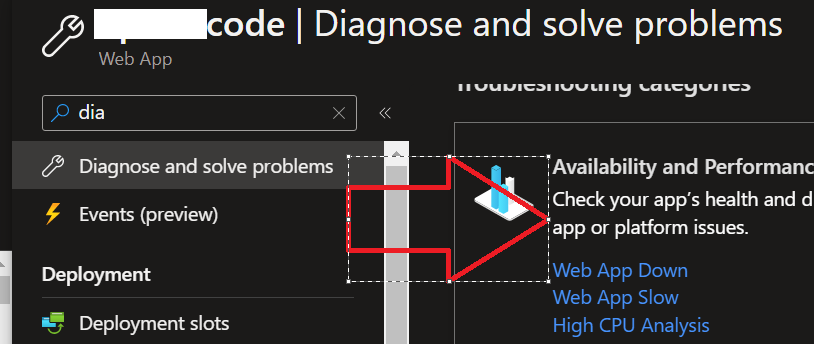

    3. You may leverage App Service diagnostics from Azure Portal> Navigate to your App Service app in the Azure Portal. (screenshot below) ---- In the left navigation, click on Diagnose and solve problems - Review - “Configuration and Management" and “Availability and Performance” options. User's image
