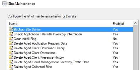

We are trying to retrieve the list of SCCM Site Maintenance Tasks via PowerShell. This is to replicate what is shown in the Config Mgr console - screen accessed via Administration --> Site Configuration --> Sites --> Site Maintenance. It provides a list in a pop up window of all the Site Maintenence tasks and if they are currently Enabled or not.

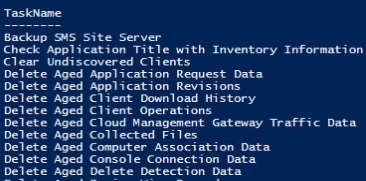

From PowerShell, we are using the Configuration Manager PowerShell module and command Get-CMSiteMaintenanceTask. But the list coming back is different. Some of the names of Tasks appear similar, but they are not the same. Also tried to query the database directly and also using command "SELECT * FROM SMS_SCI_SQLTask" using WMI. All these options give me the same list but it does not match what is in the Console window.
An example is the third item in the list from the Console called "Clear Install Flag". It does not come up in the PowerShell list at all, though there is "Clear Undiscovered Clients". I thought there was maybe a difference in description, there are columns such as TaskName, ItemName, but they are the same.
Powershell:
Console:

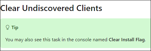

    For example, the "Clear Install Flag" maintenance task is called "Clear Undiscovered Clients" in the ConfigMgr console, this is also noted in the reference documentation in the above link:
