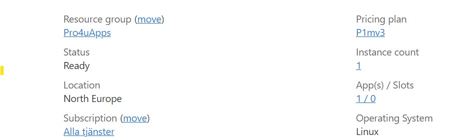

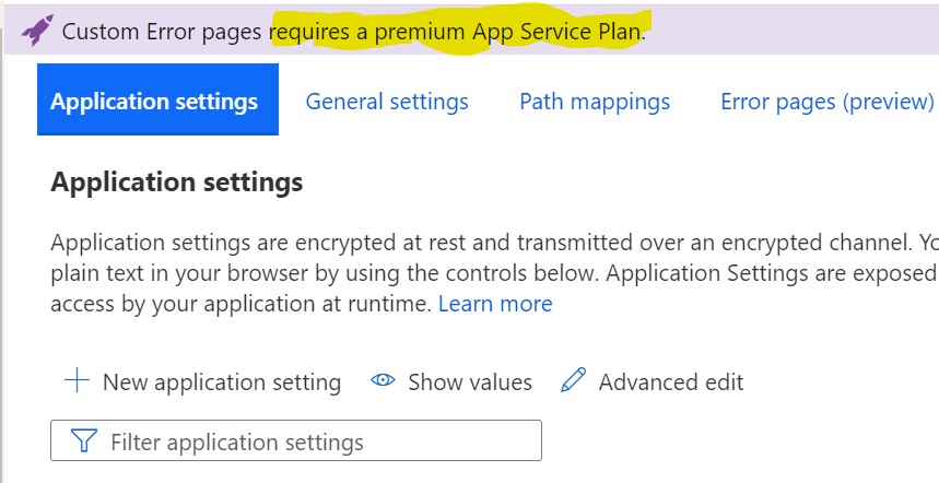

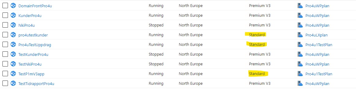

I have created a app service plan with P1mV3 computing. The plan is not recognized as a premium plan. Anyone having similar issues?

    I tested and am seeing the same thing. Tried in North Europe and East US, same results. Any of the linux PXmv3 SKUs show up as Standard.
    If I switched the plan to one of the other Premium SKUs, for example, P1V2 or P1V3, it changed over to Premium. When I switched back to one of the PXmv3 SKUs, it changed back to Standard. Interestingly, P0V3 shows up as Standard.
    I recommend you open a new support request via the Azure portal for this issue. Meantime you will need to use a different SKU other than one of the PXmv3 SKUs if you want Premium.
