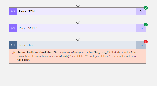

Hello I'm trying to execute below workflow but not able to achieve it
  1. I'm getting data from HTTP action in the form of JSON
  2. I need to achieve it to CSV form.
The Data Sample is attached below
  "data": {
    "Event1": {
      "Action": "Log in",
      "Data": "Master Vault",
      "IP_Address": "1.1.1.1",
      "Time": "2023-04-18 03:51:32",
      "Username": "Sam"
    "Event2": {
      "Action": "Log in",
      "IP_Address": "2.2.2.2",
      "Time": "2023-04-18 03:35:06",
      "Username": "John"
    "Event3": {
      "Action": "Log in",
      "Data": "dext",
      "IP_Address": "3.3.3.3",
      "Time": "2023-04-18 03:34:46",
      "Username": "Rizwan"
    "Event4": {
      "Action": "Log in",
      "Data": "google.com",
      "IP_Address": "4.4.4.4",
      "Time": "2023-04-18 03:34:08",
      "Username": "Prachi"
I tried to implement using variable but no progress, please let me know any working solution
