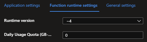

In the Configuration the Runtime Version is ~4 with no other options in the drop-down:
