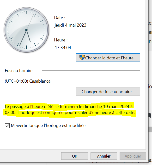

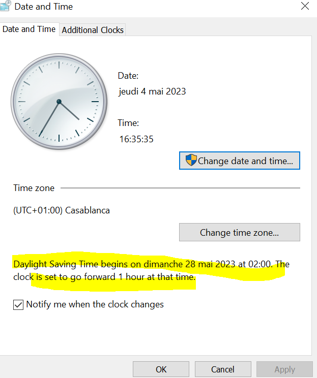

I just set an ntp server for my client, and sync it sucessfully with the PDC emulator of the domain.
The sync is ok, the tests are good, i configure the correct timezone on the PDC, but it gives the incorrect date (1 hour less than the correct date), i tried to disable/enable the daylight saving time, but nothing change.
the time that i choose is Casablanca UTC +1, and i can't understand why i have this incorrect date.
As per my understanding, the NTP is delivering Time to the servers in UTC, and then based on the timezone configured on the clients machine, the time is calculated.
For my machine the timezone is correct (UTC+1) but the time on the machines is incorrect
Any ideas please?
