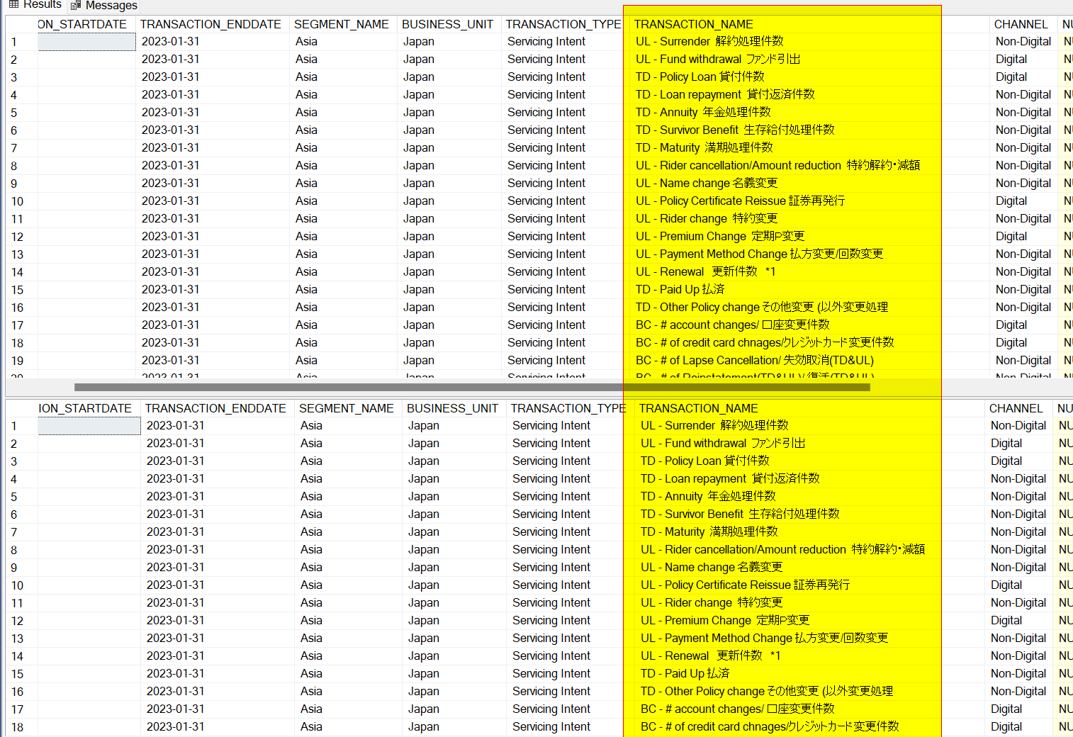

We are trying to load a csv file with Japanese Special Characters using data flow task in Azure Data Factory to Sql Server tables and it fails to render and load Japanese characters.
We notice that the Japanese special characters are substituted with ‘?’ in the database after loading. We tried different options by changing the encoding to other types (such as (Default)UTF-8, UTF-16LE, UTF-8 without BOM etc.) but still it did not help.
But when we use a Data Copy task in ADF to load the data with Japanese special characters, it loads perfectly fine.
