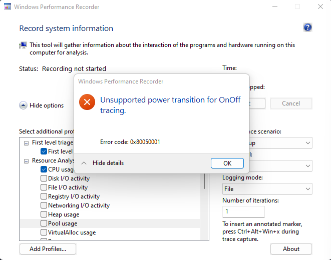

I have Windows 11 version 10.0.22000 Build 22000 and trying to examine the boot sequence for boot time optimization purposes using Windows Performance Recorder from Windows Assessment and Deployment Kit version 10.1.22621.1.
Using the guide from learn.microsoft.com I execute Windows Performance Recorder (WPR) from the Start menu with "Fast Startup" option and when trying to start the tool I receive the following popup with the fault description "Unsupported power transition for OnOff tracing".
What power transition is supported by WPR?
How to enable and activate required power transition?
Probably something is wrong with fast startup, "Boot" option is able to collect data.

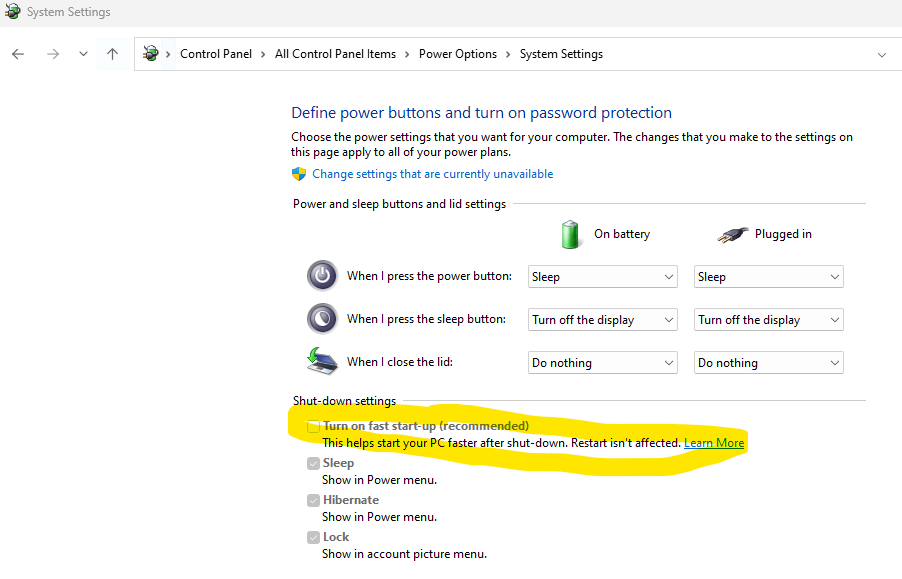

    Have you disabled "fast start-up" (as I have)?
    Gary
