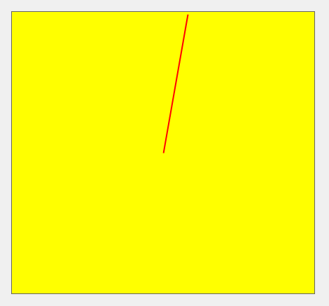

The problem is that the line also get shorter and I want to keep the line length. when it's rotating.
I'm using the method DrawLine and call it in the pictureBox1 paint event and it's drawing a line.
now I want to rotate the line in a circle without changing the center point and without leave lines behind only to rotate that line with the same radius.
like a doppler effect just to imagine what I mean by rotating.
not sure if to use a timer for that and how to do it?
private void pictureBox1_Paint(object sender, PaintEventArgs e)
            Graphics mygraph = e.Graphics;
            mygraph.DrawLine(mypen, 250, 250, x, 150);
        private void timer1_Tick(object sender, EventArgs e)
            x++;
            pictureBox1.Invalidate();

  1. Castorix31 90,686 Reputation points
    2023-04-30T08:45:08.7433333+00:00
    I used a .png in my test to avoid drawing the line.
    By drawing the line, you can do something like this with a Timer :
    At beginning (Form1_Load) :
                var timer1 = new System.Windows.Forms.Timer();
                timer1.Tick += new EventHandler(TimerEventProcessor);
                timer1.Interval = 10;
                timer1.Start();
    then :
            private void TimerEventProcessor(Object myObject, EventArgs myEventArgs)
            float m_nAngle = 0;
                var g = e.Graphics;
                g.SmoothingMode = SmoothingMode.HighQuality;
                g.Clear(Color.Yellow);
                var rect = this.pictureBox1.ClientRectangle;
                g.TranslateTransform(rect.Left + rect.Width / 2, rect.Top + rect.Height / 2);
                g.RotateTransform(m_nAngle);
                m_nAngle += 1;
                if (m_nAngle >= 360) m_nAngle = 0;
                using (var penLine = new Pen(Color.Red, 2))
                    g.DrawLine(penLine, 0, 0, 0, -rect.Height / 2);
    Rotate_Line
