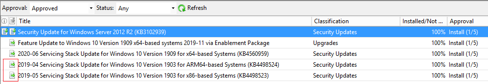

    If you approve those needed updates, and they do not install, check to see if they are missing files by enabling the "File Status" column on any of the update views that show your approved updates (https://www.ajtek.ca/wsus/how-to-setup-manage-and-maintain-wsus-part-2-computer-groups-update-views/).
    Verify there are no 'missing' files (they should all have a green icon). If they don't - those files are missing or corrupted and those updates will need to be approved/downloaded from your online WSUS server, and then re-copied to the offline server.

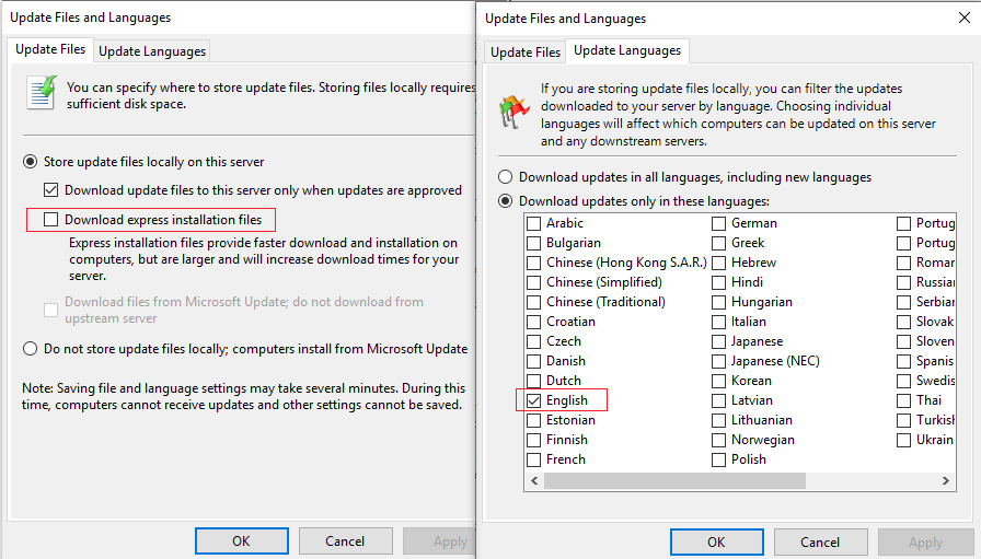

    2)Make sure advanced synchronization options for the express installation files feature and languages on the export server match the settings on the import server

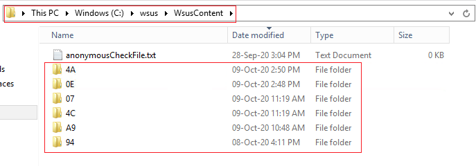

    3)Copy the Binary update file on the connected WSUS server and then post on the disconnected WSUS server

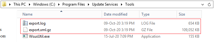

    4)Open CMD as an administrator on the connected WSUS server and navigate to the wsusutil.exe tool(Location: C:\Program Files\Update Services\Tools). And then post the following command: `
    wsusutil.exe export export.xml.gz export.log`
    Wait for a while and we will find the compressed file in the location:C:\Program Files\Update Services\Tools
    5)Last we could copy the compressed file in the connected WSUS server and then posting on the disconnected WSUS server on the same location. Then we could run the wsusutil.exe import command to import the metadata to the database.

    In addition, it is recommended to check the File Status as the below picture first:
    If the file status is correct but the clients do not install in schedule. It is recommended to check the Windowsupdate.log. We could open the PowerShell as an administrator and then post get-windowsupdatelog command to get this log. Please share with us if there is any error information.

    1. It seems some files are corrupted. It is recommended to check which updates' files are corrupted. We could decline these updates in the connected WSUS server first and then run the Server Cleanup Wizard. After those updates are been cleaned up. We could try to approve these updates again on the connected WSUS. Finally, we could export and import these updates again.
