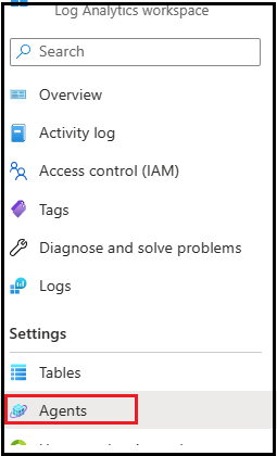

    @Julian D'Cruze , By "workspace key", do you mean the "Primary/Secondary Key" as available in Agents section of Log Analytics workspace's resource menu as shown below?
    The keys available here serve as authentication for any resource sending information to LA workspace. It could be from VM (by installing agent) OR through API as mentioned here - Send log data to Log Analytics with the HTTP Data Collector API.
    Generally, all the resources in Azure send their Monitoring logs and metrics to this workspace. However, because they are part of Azure this authentication part is taken care of by Azure platform, hence you do not have to explicitly use these keys.
    For any resource fully owned by you (you application, VMs etc.) or resources which might not be part of Azure platform but would utilize API to send data, they need these keys to be able to authenticate as mentioned here - Send log data to Azure Monitor by using the HTTP Data Collector API (preview). There is no concrete list available now, because this will keep varying depending on the use case.
