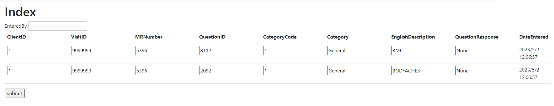

enter image description here
Best regards,
Xinran Shen
