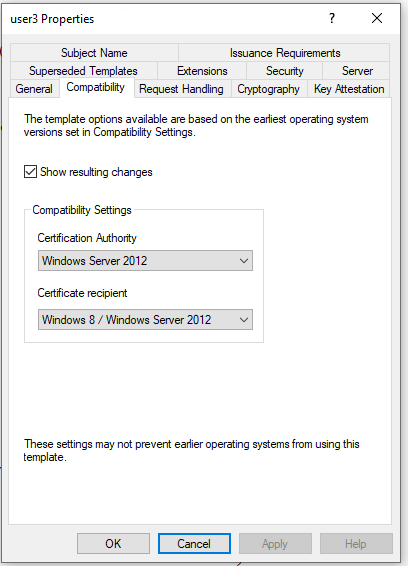

I have created a custom user certificate in the CA but from the trusted domain it does not see it.
From a computer of the trusted domain I have added the CES UI to make the certificate requests, but the created certificate is not seen when I make the request through the CES UI, however a "user" certificate that is created by default is shown.
In the created certificate, I have given read and enroll permissions to the trusted domain user and in the CA properties in security, read permissions to the same user.
Why I can not see the certificate created and if the default "user" certificate?

Ensure that template compatibility settings aren't set to higher than Windows Server 2012 R2/Windows 8.1. CEP/CES doesn't support templates with newer compatibility settings.
In addition, template propagation isn't immediate. Clients cache templates for 8hrs and do not sync with server until cache expires.

    It seems that the problem is that the 8h had not passed. Now the template appears.
