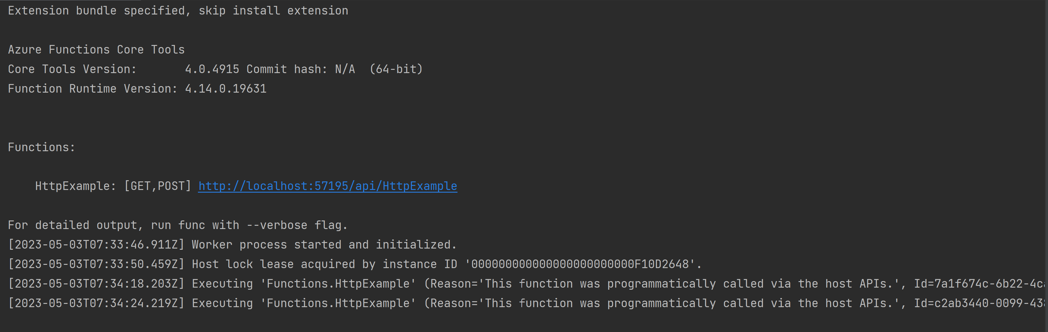

[2023-05-02T16:09:12.497Z] Worker process started and initialized.
[2023-05-02T16:09:15.362Z] Host lock lease acquired by instance ID '000000000000000000000000F10D2648'.
but when I copy that link in the browser I don't see anything, the page just keeps loading, but in the terminal, in VS Code, I can see that there is a new log:
Executing 'Functions.HttpExample' (Reason='This function was programmatically called via the host APIs.', Id=5aadbadf-3198-4532-8fdb-f704637233b3)
and that's it.

  1. Lohith GN 516 Reputation points Microsoft Employee
    2023-05-03T01:49:42.1266667+00:00
    when you pasted the link in the browser, did you paste it as "http://localhost:7071/api/HttpExample" or as "http://localhost:7071/api/HttpExample?name=Azure" ??
    According to your code - you are looking for either a querystring property called name or data in body. if you dont pass anything your code should through bad request exception.
    trying passing the name querystring property and check.
