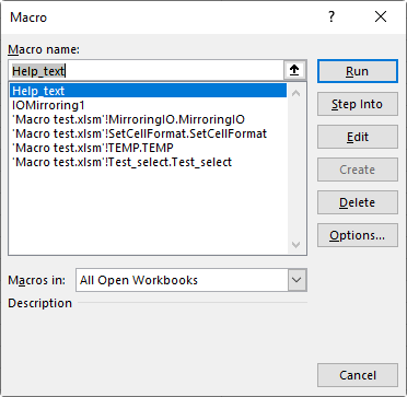

  1. Pontus Björk 25 Reputation points
    2024-05-15T13:17:08.7+00:00
    I found out that if you have the same name for the module and the Sub then shortcuts won't work. I added a number to the Sub name and the shortcut started working again. You could also see it when opening the macro window with all macros, if they have the same name it will include the name of the excel file otherwise it will only contain the Sub name.
