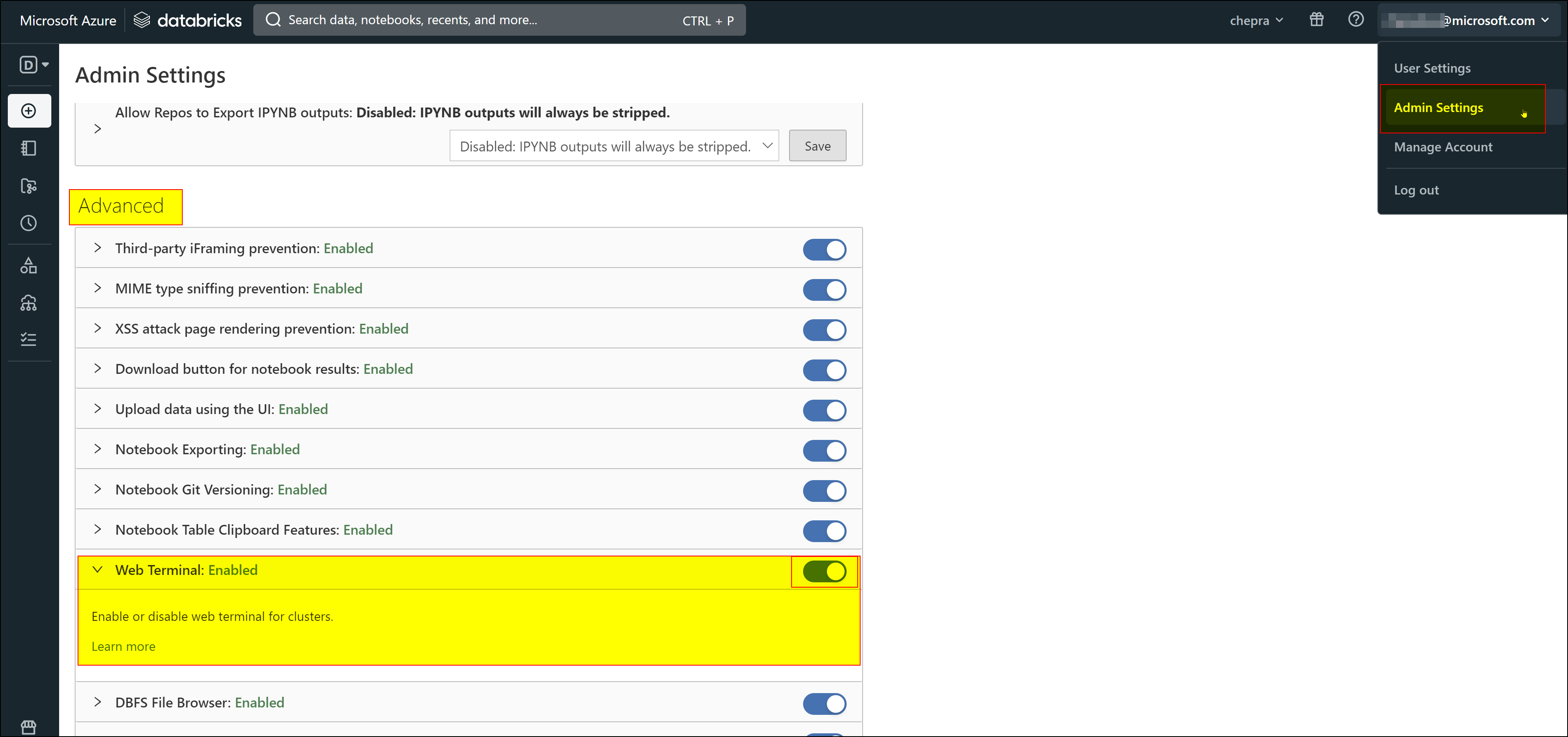

    Steps to enable the web terminal:
    Go to admin settings => Advanced => Web Terminal: Enabled (Switch toggle ON)

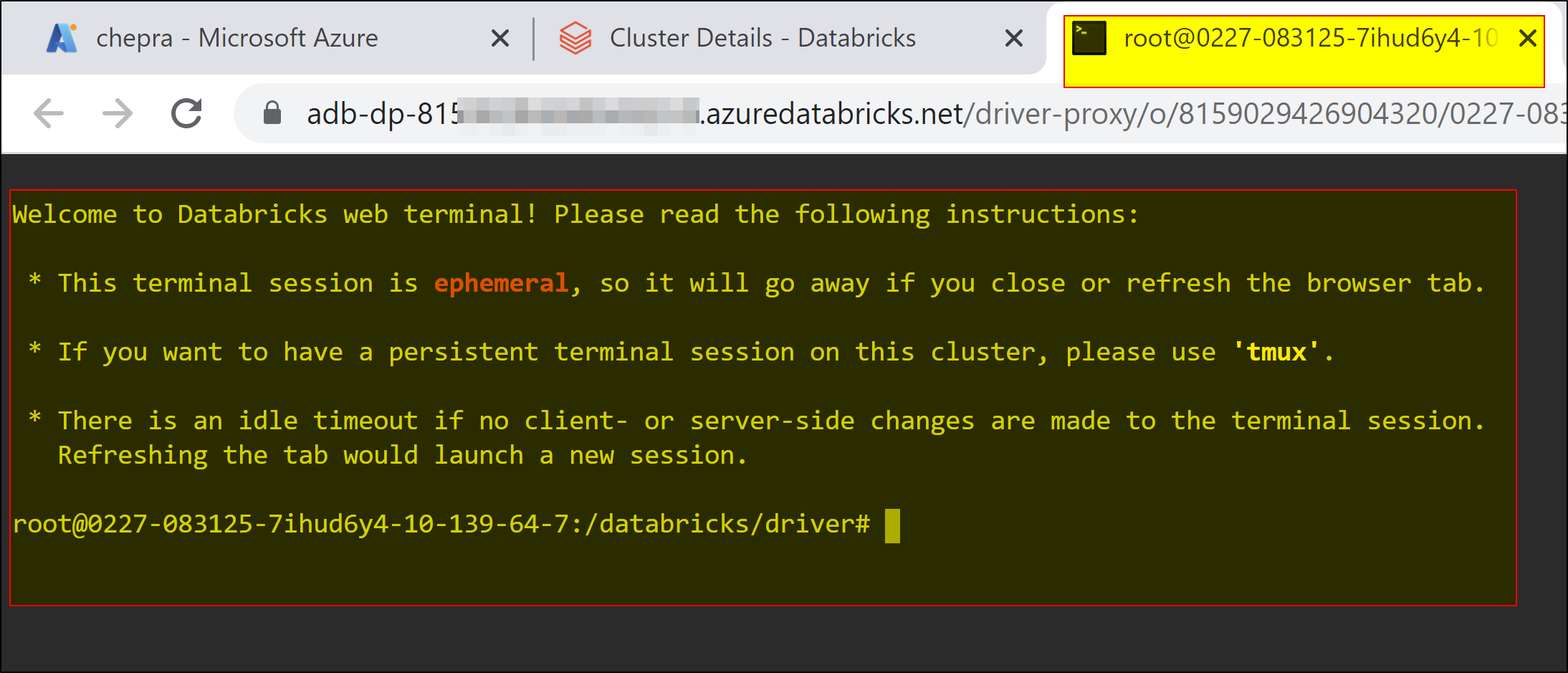

    Steps to access the web terminal:
    Go to cluster => Select cluster which is (Running) => Apps => click on Web Terminal to access.
    Now we are able to access the web terminal as shown below:

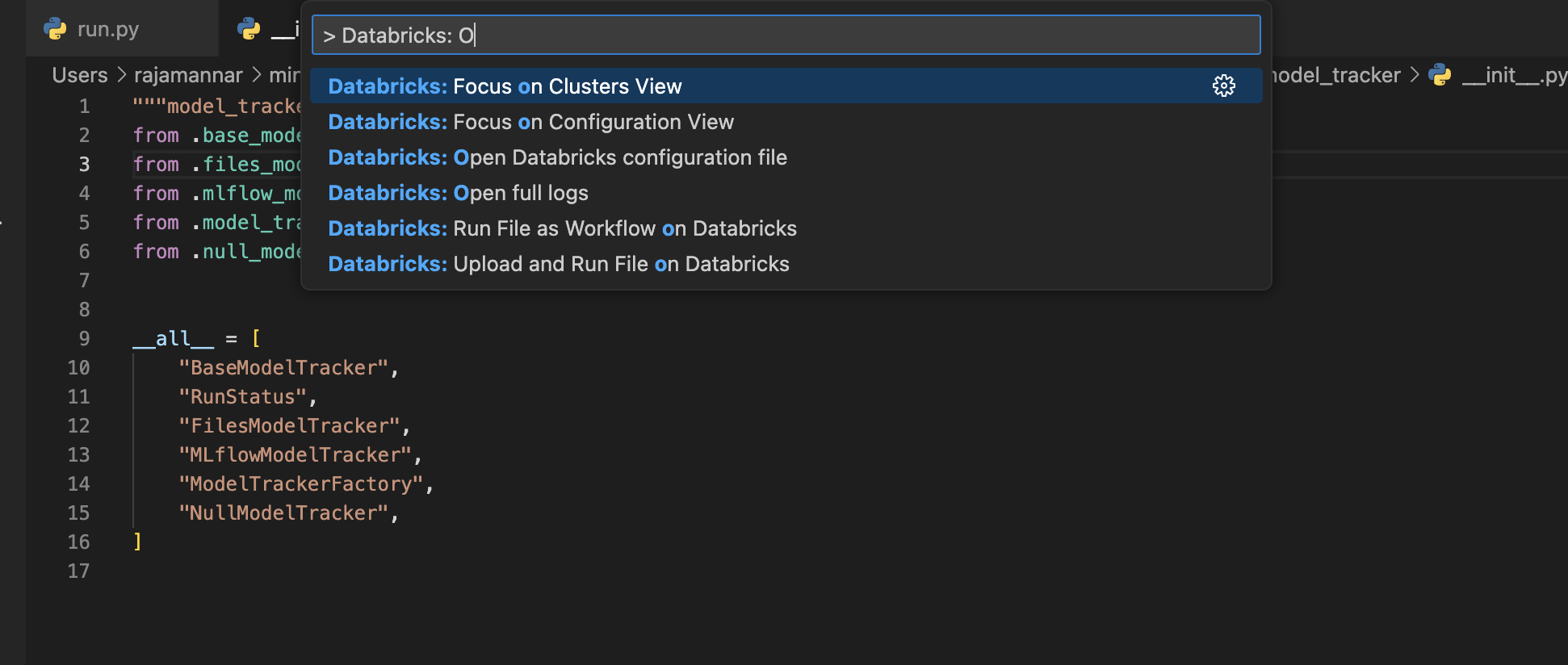

    If you want to connect to the Databricks compute terminal using Databricks VS code extension. You can follow the steps metioned here:
    The Quick Start Guide provides an overview of common features.
    The User Guide contains comprehesive documentation about the Databricks extension.
    Summary on how to connect databricks compute terminal using Databricks VS code extension:
    Open VS Code => Install databricks vs code extension => configure extension => create a python file => Attach a running cluster => "Run" icon in the tab bar and select "Upload and Run File on Databricks" => Check the debug console for the output.
