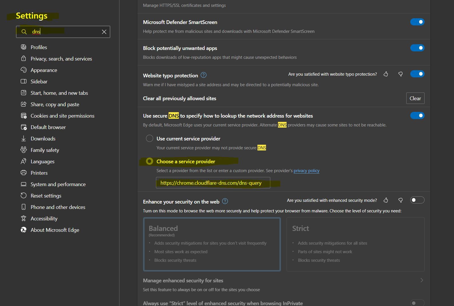

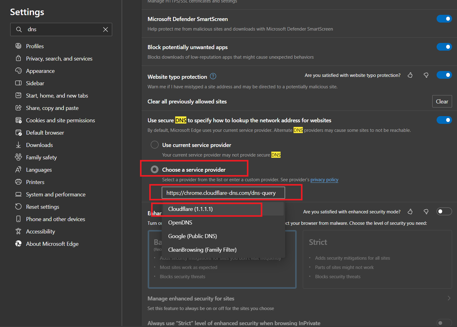

    1. Set MS EDGE DNS Settings (mentioned in the previous solution) the DEFAULT and close/open web browser
