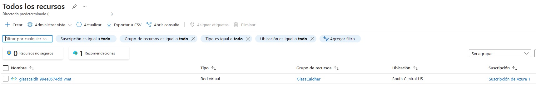

I tried all the possible solutions on the forums and Q&A post related but still cant delete that resource. I need technical help please.

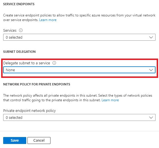

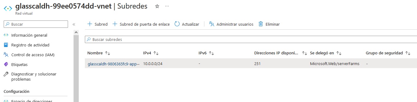

    In the Azure portal, please open the Virtual Network, click on Subnets blade, then click on glasscaldh-9806365fc9-appsubnet. Under Subnet Delegation, change it from Microsoft.Web/serverFarms to None, click Save. Similar to screenshot below:
    azure vnet subnet delegation
    After completing the above please test to see if you can delete the VNet. It may not allow you to remove the delegation. If it gives you an error, please leave a comment.
    Thanks.
