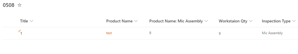

Hi Guys:
  I have a list with lookup value, the lookup source is product name, the lookup value is the column "Product Name:Mic Assembly", and if the Inspection Type is "Mic Assembly", I hope the Workstaion Qty will be "9" as shown in the "Product Name:Mic Assembly" column.

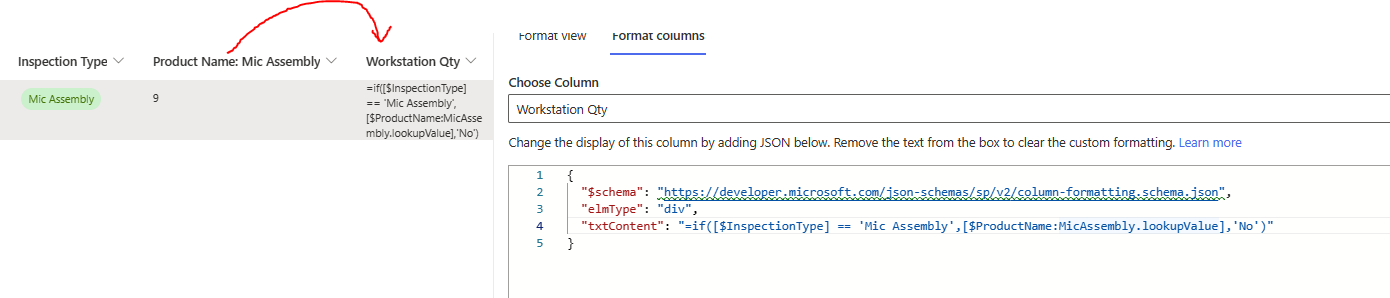

  But the expression below can't get the value, could you help check the reason? "[$ProductName:MicAssembly.lookupValue]" may be a mistake, but I don't know how to correct it.
  1. Emily Du-MSFT 51,846 Reputation points Microsoft External Staff
    2023-05-08T08:00:07.1366667+00:00
    Please use following formula in the JSON formatting.
      "$schema": "https://developer.microsoft.com/json-schemas/sp/v2/column-formatting.schema.json",
      "elmType": "div",
      "txtContent": "=if([$InspectionType] == 'Mic Assembly', '[$Product_x0020_Name_x003a__x0020_]', 'NO')"
