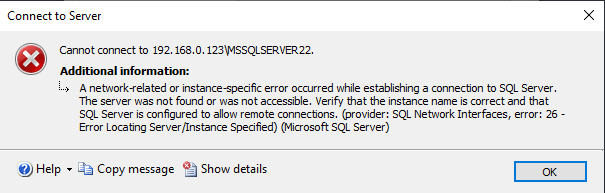

I setup a VM (VMWare) to test SQL Server 2022
I used SQL Server Config Mgr to allow remote access and set the port
I can connect to the instance locally from SSMS and and connect to other instances (2019) from this VM
but I can't connect remotely to this instance from this VM or a physical PC
The VM and PC are in the same domain and I am using the domain Admin user id

  1. Erland Sommarskog 128.9K Reputation points MVP Volunteer Moderator
    2023-05-05T21:34:09.8966667+00:00
    What error message do you get?
    Did you start the browser service?
    How do you connect? By instance name or port?

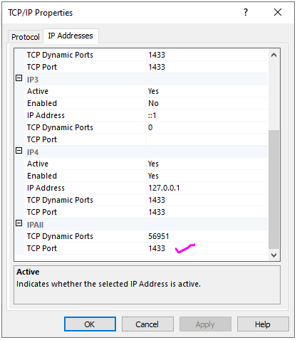

  2. Thirthaprasad S G 36 Reputation points
    2024-11-27T06:33:08.04+00:00
    Hi All,
    I forgot to mention that, even the LOCALHOST was unable to connect to port 1433 in the present scenario. In previous versions of SQL (2014) though it was connecting Remotely but wasn't happening with localhost.
    I have finally figured it out. It is the TCP/IP port for "IPAll" portion which was not specified to use 1433 leading to this connectivity issue with localhost as well as from Remote Hosts. Once I specified the port 1433 in IPAll settings and restarted the SQL Server service, both connections worked successfully.
    Below is the screenshot of that particular setting which worked for me...!
