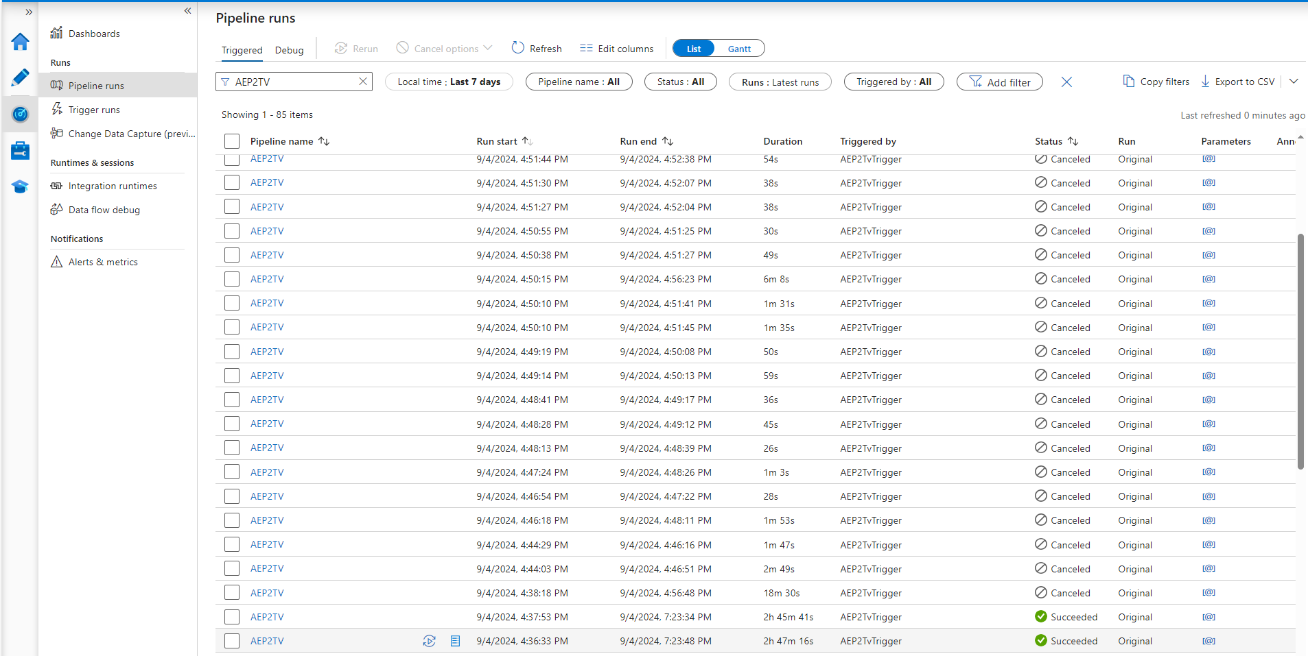

We're seeing an odd issue with Data Factory deployments and Trigger behavior. As is normal for many people, we're housing our ARM templates in Git, publishing from the collaboration branch to UAT/Production via Azure DevOps, and using powershell commands pre/post ARM Template deployment to stop and start our Triggers.
This was working quite well up until about 4-6 weeks ago. Now, we're seeing the oddest issue; some, but not all, triggers that are enabled via the powershell command are then executing their associated pipelines, instead of waiting for their scheduled execution time. Further, the same thing is occurring when we manually enable stopped triggers in UAT/Production, and then publish said changes to Data Factory.
If anyone has thoughts on this or seen said behavior before, I'd love to know if there is a workaround. At this point, we've had to disable the Trigger restart step in our ADO Release pipeline, then after a Data Factory deployment is complete, manually re-enable Triggers and immediately stop their pipelines from running, post-deployment.

    You may be using tumbling window triggers here. Tumbling window triggers will run all past windows as well once they get publish. If you don't want that behavior then consider creating schedule triggers.
