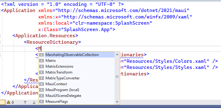

I have to change resource folders for icon, image and splash screen I read in the manual that you just need to modify the app project file by inserting for example the following code:
    <ItemGroup>
         <MauiSplashScreen Include="Resources\Splash\*" />
    </ItemGroup>
I can't understand and find this file it should have xml extension Thanks for your help

    2023-05-07T19:12:31.8433333+00:00
    The resource file you are referring to is an XML file that contains information about the resources used by your Maui .NET application. This file is typically named "App.xaml" and is located in the "Resources" folder of your Maui project.
    To modify the resource folders for icons, images, and splash screens, you can add the following code to your App.xaml file:
    <Application.Resources>
        <ResourceDictionary>
            <MauiImage Include="Resources\Images\*" />
            <MauiIcon Include="Resources\Icons\*" />
        </ResourceDictionary>
    </Application.Resources>
    This code defines three different resource types: MauiSplashScreen, MauiImage, and MauiIcon. Each of these types includes a set of files that are located in the specified folders.
    Note that you will need to replace the folder paths in the code above with the actual paths to your resource folders. Once you have made these changes, you should be able to use the new resources in your Maui .NET application.
