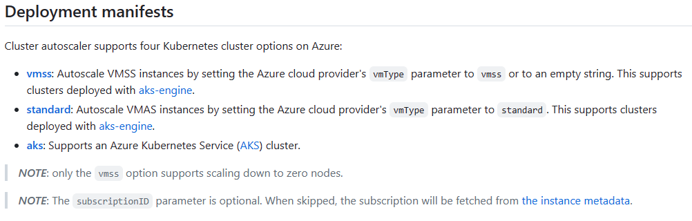

I want to install Cluster AutoScaler for an AKS Cluster manually (not enable cluster autoscale) but it doesn't work.
I tied many ways: using helm chart, using yaml files, but no one works.
I referred to some examples here:
https://github.com/kubernetes/autoscaler/blob/master/cluster-autoscaler/cloudprovider/azure/examples/cluster-autoscaler-vmss.yaml
https://www.djmolding.com/
https://github.com/kubernetes/autoscaler/blob/master/cluster-autoscaler/cloudprovider/azure/examples/cluster-autoscaler-aks.yaml https://github.com/kubernetes/autoscaler/blob/master/cluster-autoscaler/cloudprovider/azure/examples/cluster-autoscaler-autodiscover.yaml
I checked logs of cluster autoscaler pod, it has following messages:
Failed to scale up: Could not compute total resources: No node info for: agentpool
Is there any solution for this?

  1. vipullag-MSFT 26,487 Reputation points Moderator
    2023-05-11T04:29:18.83+00:00
    Hello AnonymousHeart
    Welcome to Microsoft Q&A Platform, thanks for posting your query here.
    As per the documentation (https://github.com/kubernetes/autoscaler/tree/master/cluster-autoscaler/cloudprovider/azure#deployment-manifests), the only method supported by AKS is via "az aks" command:
    The first two options (vmss and standard) are for aks-engine, which a different product than AKS managed solution.
    Hope that helps.
