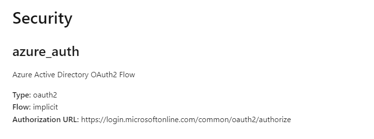

HI Team,
I am trying to stop my function app inside itself on certain conditions.
I landed to below page.
https://learn.microsoft.com/en-us/rest/api/appservice/web-apps/stop
Can you please elaborate how we can do below Security?
Is there any other way to stop function app?
I also read a function app can be disabled if "AzureWebJobs.disablefunction.Disabled" is set to true in Configuration Settings.
But issue here is I am not able to update "AzureWebJobs.disablefunction.Disabled" value in Configuration Settings through code in Function app.
Any inputs?

  1. MayankBargali-MSFT 70,981 Reputation points Moderator
    2023-05-09T05:15:37.5733333+00:00
    @Sairam Ganji Thanks for reaching out. To disable the function please refer to the disable function document.
    You can leverage the Azure REST API to programmatically stop your azure function and to know more about the Azure REST API, authentication etc. please refer to this document.
    You can also use the below REST endpoint to enable/disable a particular function
    PUT https://management.azure.com/subscriptions/{subscriptionID}/resourceGroups/{resourcegroupname}/providers/Microsoft.Web/sites/{sitename}/functions/{functionappname}/properties/state?api-version=2022-09-01
    content-type: application/json; charset=utf-8
    Request Body:
    {"properties":"disabled"}
    OR
    {"properties":"enabled"}
    Alternative you can also use this API to update app setting on your function app.
    In case if you want to do it for your local environment then you can define below in your local.settings.json but when you deploy to azure then you need to define it in Application setting of your function app.
    "AzureWebJobs.yourfunctionname.Disabled": true
    OR
    "AzureWebJobs.yourfunctionname.Disabled": 1
    Feel free to get back to me if you need any assistance.
