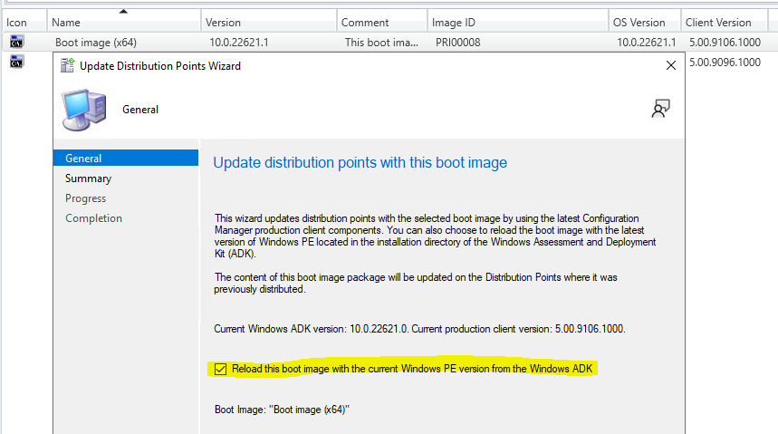

  2. AllenLiu-MSFT 49,316 Reputation points Microsoft External Staff
    2023-05-09T06:45:51.8066667+00:00
    Hi, @Glover, Mike
    Thank you for posting in Microsoft Q&A forum.
    After we reinstall ADK, have we updated distribution points of the boot image with checking "Reload this boot image with the current Windows PE version from the Windows ADK"?
    1
    If the answer is the right solution, please click "Accept Answer" and kindly upvote it. If you have extra questions about this answer, please click "Add comment".
