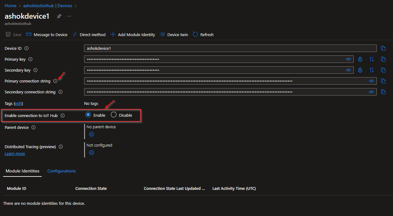

    • Make sure that you have provided the correct connection string for the device you want to fetch data from. You can check the connection string in the Azure portal by going to the IoT Hub, selecting the device as shown below. User's image
    • Check if the device is registered in the IoT Hub. You can check this by going to the IoT Hub, selecting the "IoT devices" tab, and then look for the device you are trying to connect to.

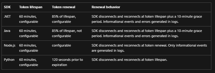

    Azure IoT device SDKs disconnect from IoT Hub and then reconnect when they renew SAS tokens over the MQTT (and MQTT over WebSockets) protocol. In logs, this shows up as informational device disconnect and connect events sometimes accompanied by error events.
    By default, the token lifespan is 60 minutes for all SDKs; however, it can be changed by developers in some of the SDKs. The following table summarizes the token lifespan, token renewal, and token renewal behavior for each of the SDKs:
    For more details, please refer to MQTT device disconnect behavior with Azure IoT SDKs
